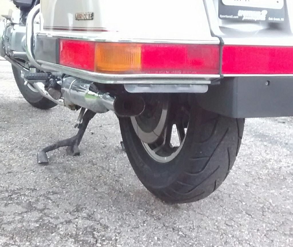

« Reply #18 on: May 26, 2015, 05:12:30 PM »
A bit off topic but I'm fanatically in the Michelin Commander II (bias) camp after running one on the rear of a gl1200 Goldwing three months and 3500 miles this spring.  It was quiet, stuck like glue both dry and wet and showed little signs of wear.  A Commander II will be replacing the Bridgestone radial on the rear of my I/S soon.
Here's a pic of a Shinko 230 Tourmaster at 4500 miles:
And one of a Michelin Commander II at 3500 miles:
