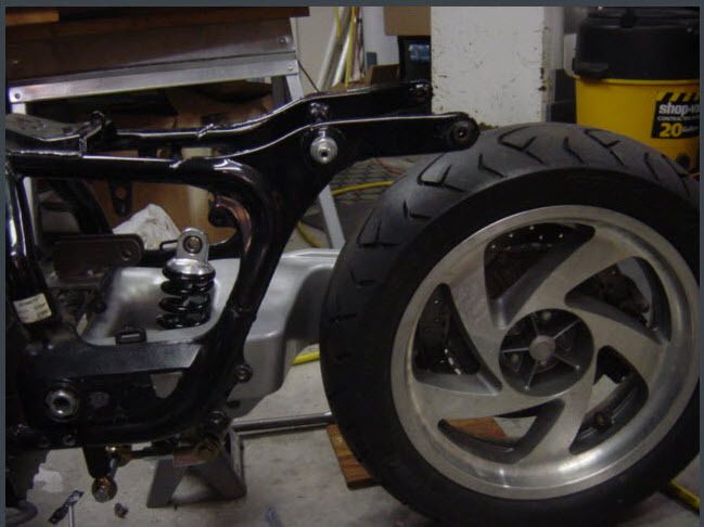

Thanks guys.  I found a pic - I think from Jeff?  But most of the reference posts on this topic have busted pic links.

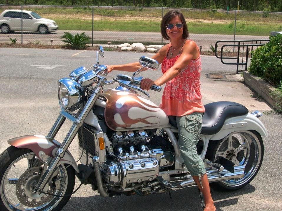

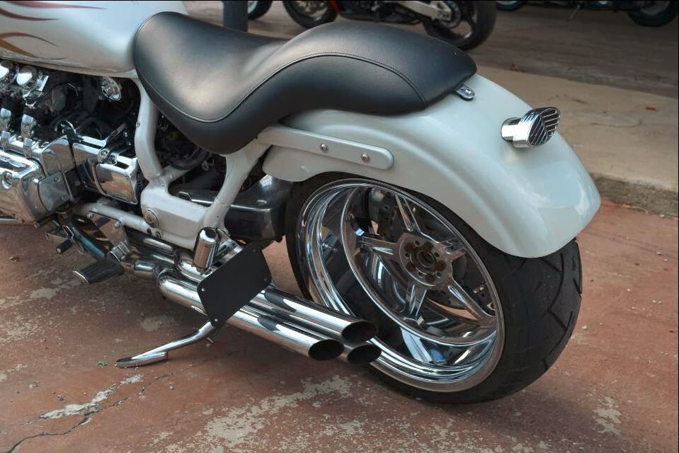

I found a Valkyrie that was converted down in Florida a few years ago, talked to the guy that had it in his shop.
Here are the pictures I saved.
https://www.dropbox.com/s/p8994kkko77au0z/SS_valkyrie.JPG?dl=0
https://www.dropbox.com/s/207zl47yyr7481j/SS_valkyrie2.JPG?dl=0
there is a video on Youtube of it also.
https://www.youtube.com/watch?v=OM_N9mRWV0k
yes the stock valkyrie frame is way to weak to handle the conversation to single sided swing arm.. but if you have a big enough wallet anything is possible.

While the "naked" side pics are great, seems no one has pics from the other side.
Would have loved to see the extent of frame mods necessary for the monoshock; it's always easier having a guide... Grin

That "Florida" bike was on eBay a year or so ago.  Don't know what it went for.
Seem to remember reading the description for that bike and the guy had said that there were some issues still to be resolved with the bike.  Don't remember what those were but I think it was still some unresolved issues with the swingarm.

BF is correct it was on eBay but it never sold back in 2012.
I talked to the shop that listed the bike and shared a few emails with them.

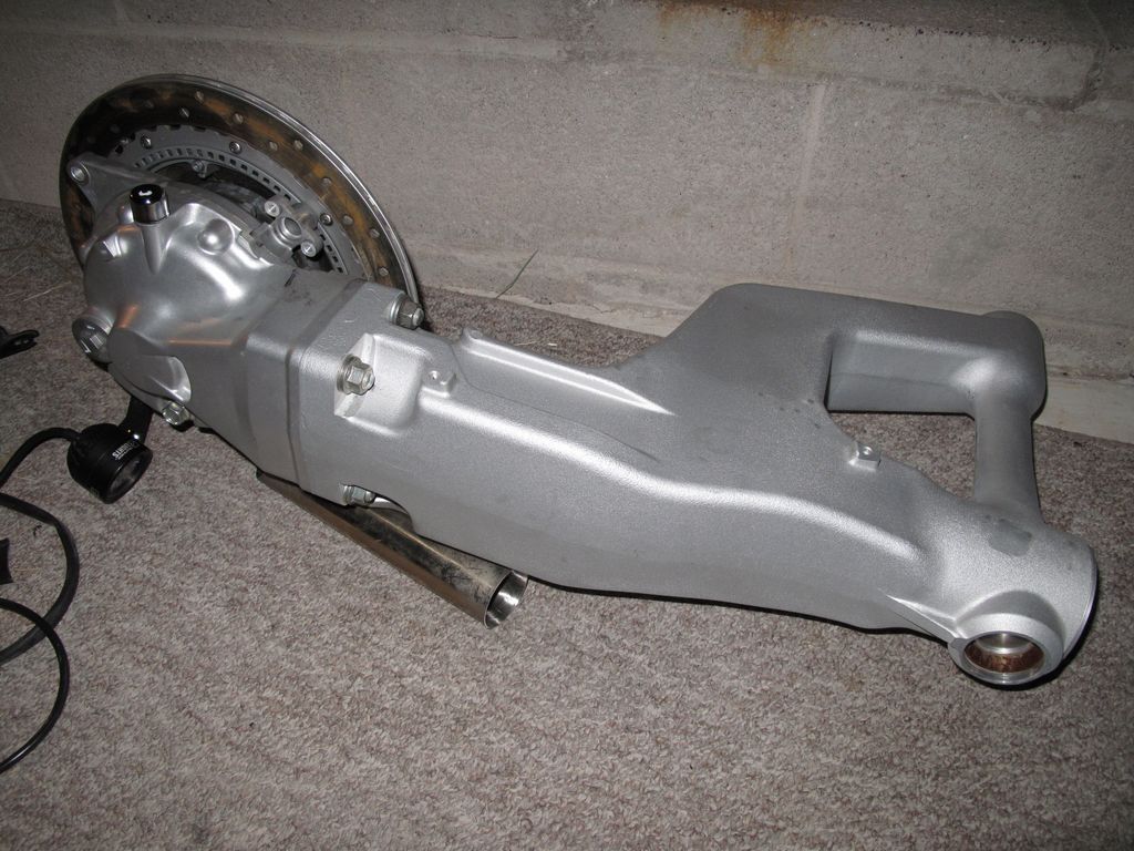

Stopped by my local Indy Wing store, and was able to score some hardware.
$200 for a swingarm, pumpkin, rotor, driveshaft, swingarm bolts/bearings, wheel, caliper, shock, articulating shock stuff, and a fair tire... cooldude The shop does a lot of trike conversions, plus I think they take pity on my moto project affliction... uglystupid2
Assembled and measured today, and it looks like the 1800 swingarm is 23.75 inches from pivot to axle.  I thought ...dang, that's long.  Then measured the Valk: 23.25". Wink
Been trying to get the Valk hack running, so won't have much free time for awhile; but this certainly looks viable.  The swingarm fits in the frame, the length is close enough, and the rear tire is still a 16, so won't have to worry about ride height...much.
Still need to find one of those hydraulic gizmos for the rear shock off ebay.
I think the frame strengthening is going to be the most interesting.  Even Honda did not get it right the first time...
