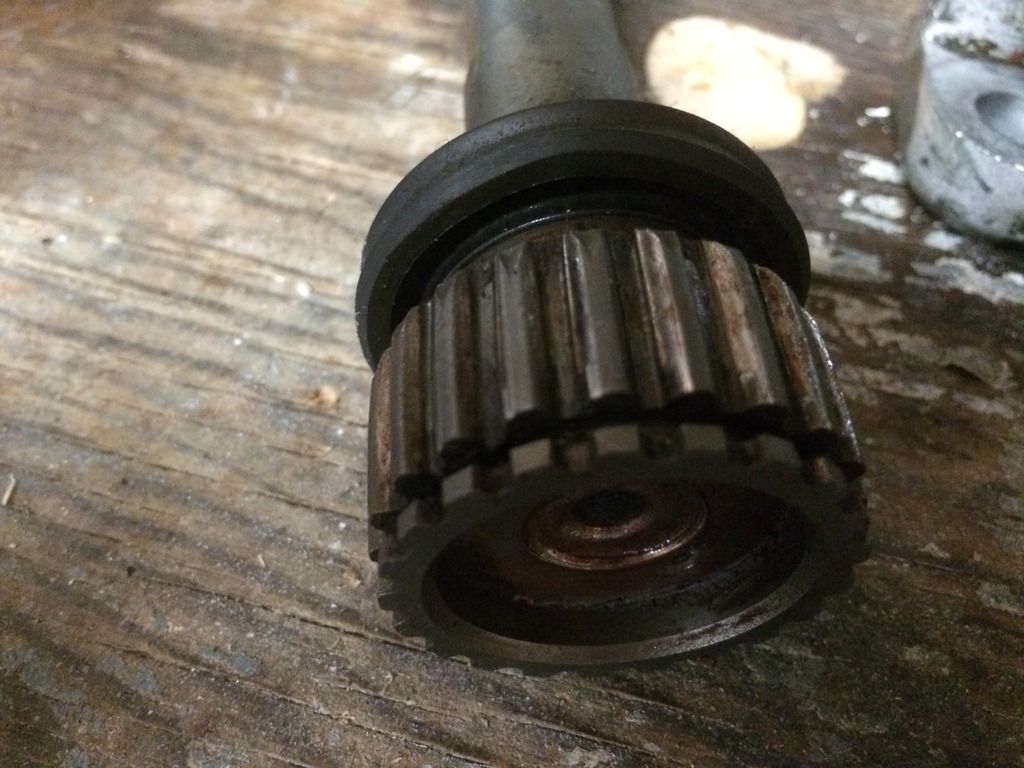

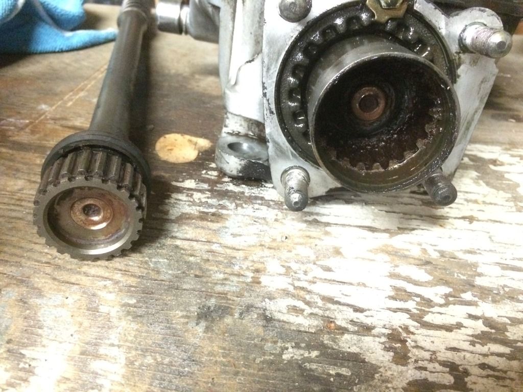

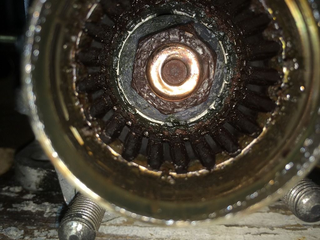

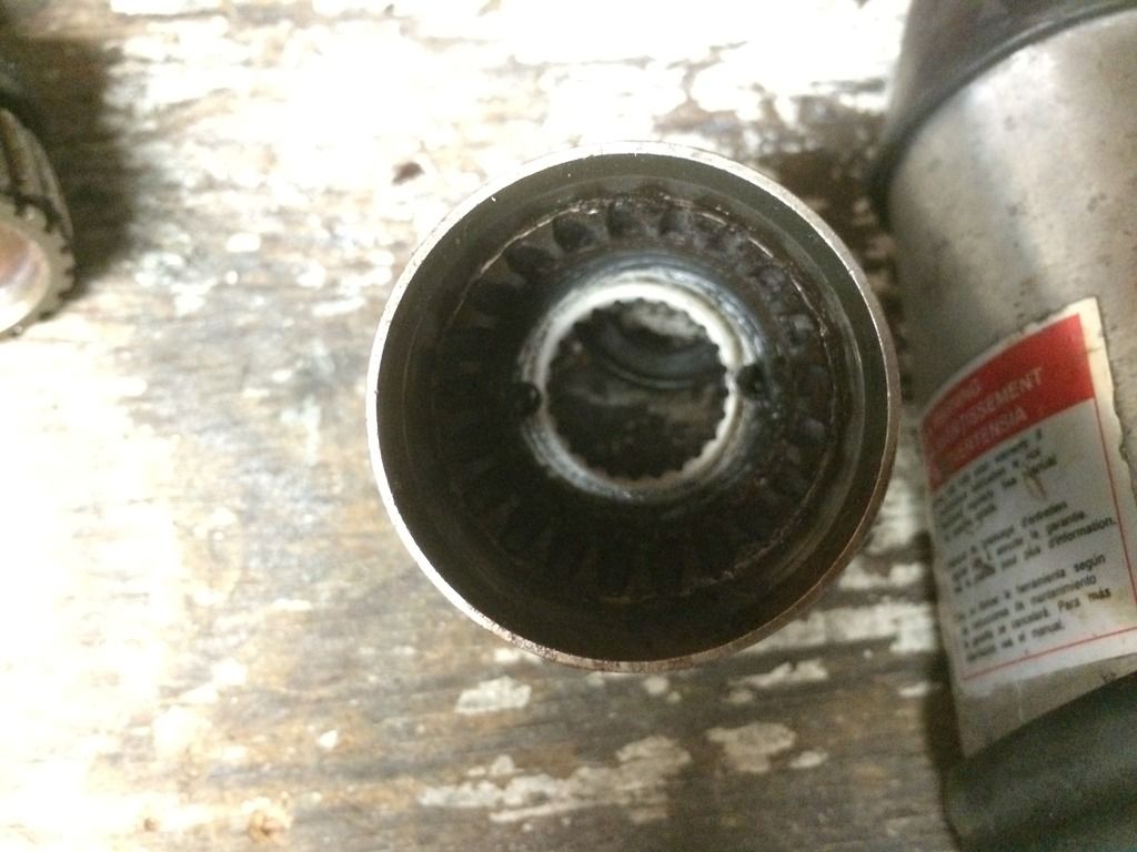

Well she is all pulled apart, and things are better than expected and some are really bad.
Ding ding ding those who said pinion cup are partially correct, it is worn and associated parts will be replaced. This who said U-Joint are the big winners. U-joint is blown up I will post picture tonight from work since I am on my phone right now. Thanks everyone for the help it's appreciated.
So I have pinion cup and drive shaft question, how much movement should be in the connection? The drive shaft would move side to side actually more of a wiggle the amount of deflection on the U-Joint side while shaft is still in the pinion cup.
I might have some sort of engine oil leak? Underside is filthy from oil and grime and oil is a little low on the stick I still have oil touching the stick but only by about 1/8".
Thanks again pictures should be up before morning.

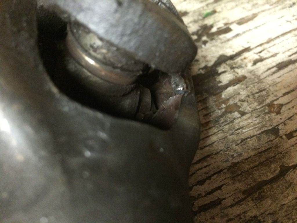

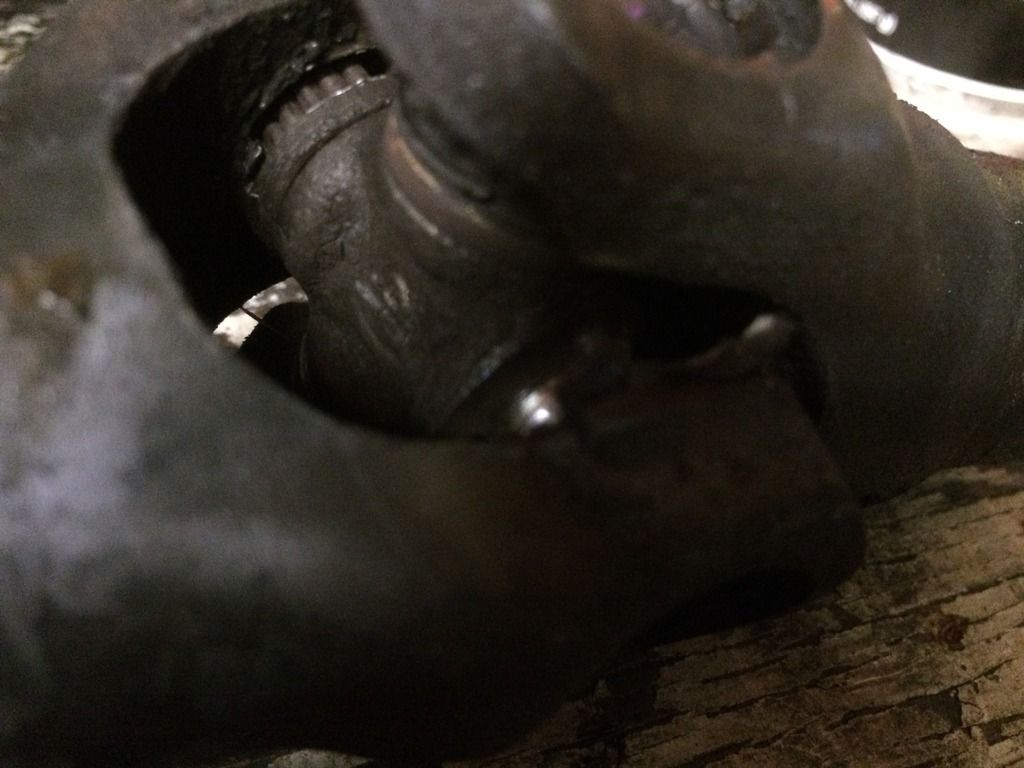

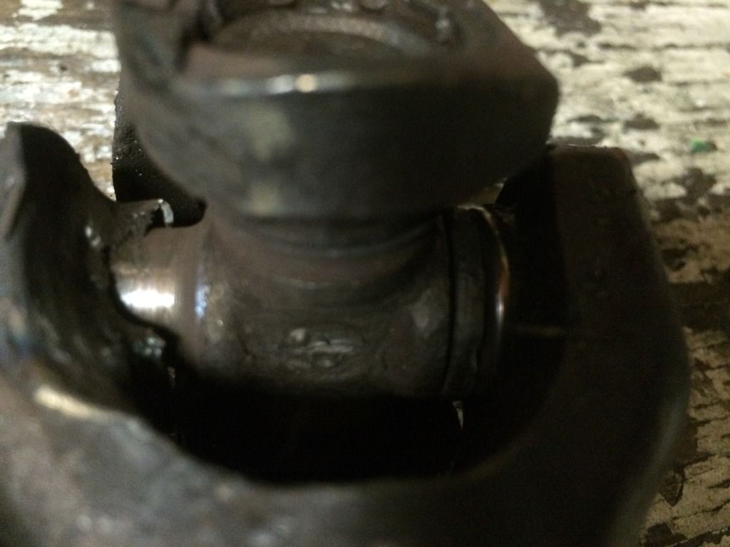

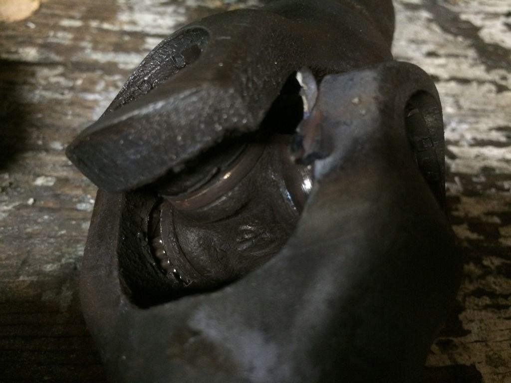

The U-Joint is BLOWED THE HECK UP. The Drive shaft definitely has some wear and the Cup also has a fare amount of wear.
So it looks like for safety I will replace all 3 and the associated split ring and seal on the shaft.

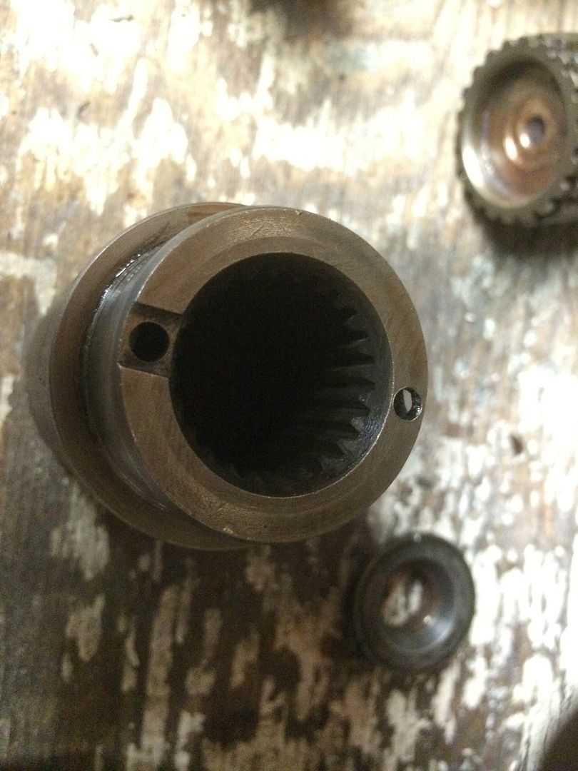

Are these the holes that need to be kept cleaned out for lubrication of the pinion cup splines?
83GS550
93XR650L TARD!
97WR250
99ValkyrieI/S Tri-tone
01YZ125(x2)
05DRZ-125
« Reply #16 on: June 27, 2015, 11:04:18 PM »
Whoa, that U-joint is in a bad way ! The pinion and driveshaft don't look that bad, but I can see the point in doing them now. Yes those the holes in the cup for lubrication. But make sure you don't just rely on that. Lube them well.

Thanks meathead, yes I will use an ample amount of grease on all friction points.

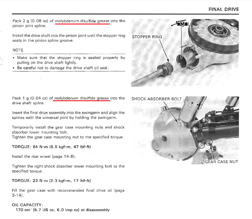

I guess I never actually serviced the Pinion Cup, I say that because I don't remember seeing the inside of it or that end of the drive shaft before. I have had the U-Joint out a couple years ago.
Moly Grease? ???
No moly paste, like GuardDog? ???

« Reply #18 on: June 27, 2015, 11:45:12 PM »
Yeah that u-joint looks like it's only got a couple more miles in it. I believe it's moly grease in the pinion. I was using paste and it was pointed out to me it's supposed to be grease. I put it on the shaft and inside the cup. On the shaft end that goes in the u-joint I use the Honda moly60. Removing the circlip and spring is a pain in the butt for one person. If you can get someone to help I would. Somebody made a jig to hold it in place for removal. You might find that in a search.

I went to Inzane and back for two years in a row with drive shaft / pinion cup splines that looked worse than those.  I have photos showing them last year before Inzane and this year before Inzane.  See here (scroll way down for this year's photos):

Those splines require 3% moly grease.

I agree with Gryphon Rider. The shaft and pinion isn't that bad. I would either keep them on and hang on to your new ones or keep the used ones as spares. But don't mix the new shaft with the old pinion and vice versa. And now I remember it was G.R. that set me straight on the pinion lube  cooldude

Thanks again guys, figure I will put the new parts in and keep the old ones as spares as suggested.
I think the green grease I used in the past is 3% moly so I should be safe with that.

I am taking a break from the reassembly about 1/2 done ujoint is back in diff and drive shaft in place everything greased wheel back on brake assemy back in place,,,  sure am glad I started typing this since I had forgotten about tightening the 4 diff to swing arm nuts. Gotta do some clean up since I have grease and horrible grime everywhere more now than when I started I managed to get grease and or gunk on every dang part of the bike.
