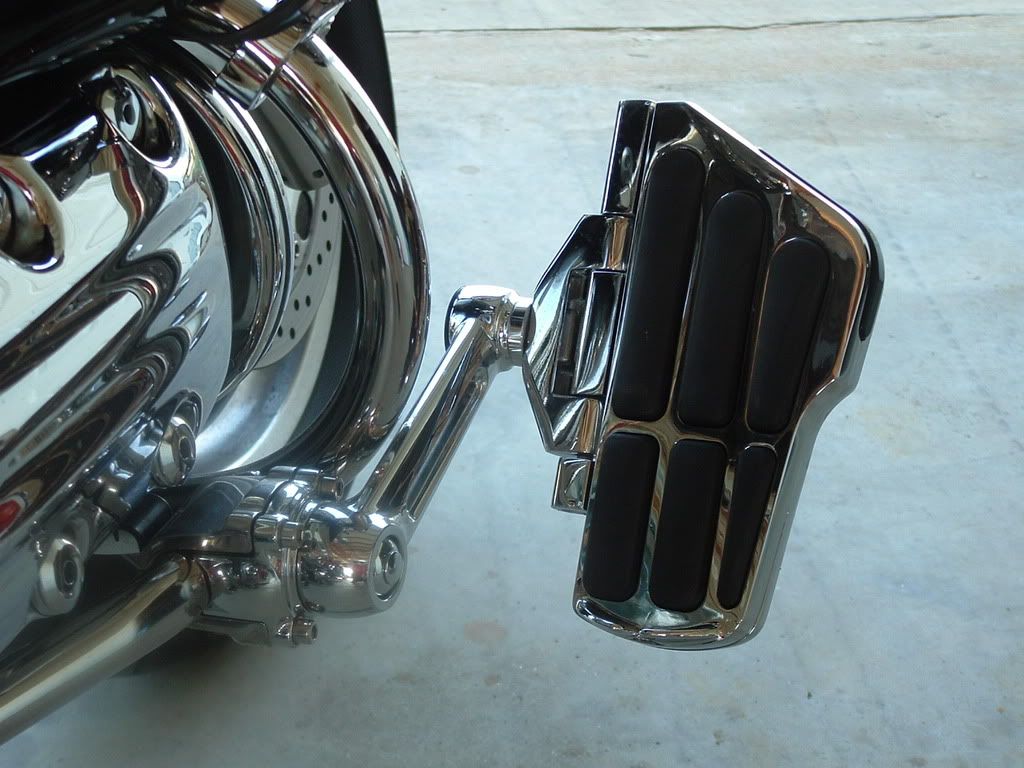

I love these. They have a heel cup that helps keep your foot in position. You have to be 6'4" to be able to reach. Short guys needn't try. Kury 4040 unlighted or 4041 lighted.
The info says for standard & tourer, but I made it fit the I/S by cutting off the air scoop and taped off the crash bar and spray painted with chrome paint. Can't notice. Also had to use some JB weld on the left side because the screw holding the floorboard kept coming loose. Caught them on sale for $200.00

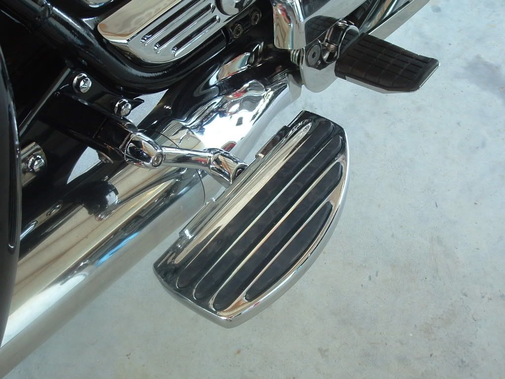

Also got the matching floorboards for Anita. kury 4455 boards, 4557 adjustable lockable offsets (4", they have a 2" available) with male mount 8825? Look at the pics for mounting.
These were a job getting everything right. The adaptors they recommend don't work plus we threw away a couple other parts you don't need.

is that the passenger floor board? or are you using that for another position for you? that is a good looking setup
