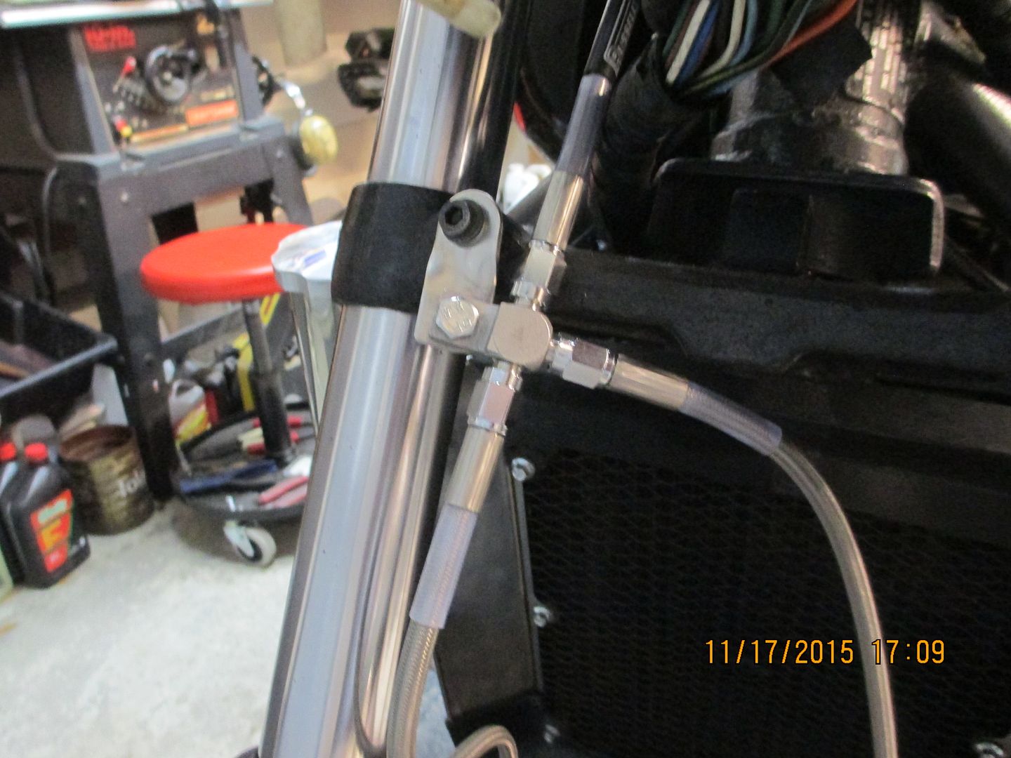

I guess it's back to the drawing board. As an experiment to lessen the chance of air seeping in, I removed the bleeders today and wrapped a slim strip of teflon on the threads then started over on the bleeding. It had drained the m/c so I used my auto-feed bottle and set it up top again. Using my air driven bleeder, I bled the left side first(farthest away from the m/c), ran it until there was no sign of air coming through. Then moved to the right side, did the same there. Result, a lot of brake fluid passed along with air bubbles on both sides but little brake action at the handle. I get a slight amount of resistance when down to 1/2" from the grip. I'm at a loss; new m/c, new brake lines, rebuilt calipers, new pads, everything is tight.....including my jaws now. I've been working on this part of the build off/on for over a month.
I'm beginning to think a friend of mine is on to something(find a nearby pond) unless someone has some spending money burning a hole in their pocket. Everything is either new or rebuilt on the bike except the engine, I'm getting tired of it and this brake problem isn't helping.  tickedoff

This is how I have it set up now, a single line from the m/c to the tee, then branching off to either side. Basically the same setup I did on the Valk and it's solid, the 1200.....squish. I'm debating picking up a splitter that Honda used on the 1000 Wings, '79 or '80 didn't have the brake light switch mounted on it. Don't know if that would help the cause or not, doubtful. Although I don't like the appearance of the dual lines from the m/c, I may need to go that route. A few more experiments to do before I give in.

Daniel, I'm going to a local speed shop and see if they have an AN3 cap I can use on the tee. Figure I'd try disconnecting & capping off where the line goes to the left side, then see if it will bleed down properly. The m/c pumps up solid if I remove the hose from it and plug the output. Thought I might try Knockdolian's procedure and try bleeding one section at a time.
This whole problem just doesn't make sense to me. The OEM m/c for the 1200 is larger than the Valk, and it only operated one caliper, whereas the Valk m/c operated two. That's why I don't think it's a matter of too small a m/c. I'm getting tired of that sickenly sweet smell of brake fluid and want to move on to something else to get frustrated over.  Grin
PS: Meant to add....the bleeders are ~2" above the banjo attachment point for the hoses, essentially on the high side of the calipers.

This is an '84 Std. and also came with the integrated brake system, which I did away with. I plugged one of the outlets on the rear m/c, used a single line to the rear caliper. Then as the pix shows, a single line from the front m/c to a splitter/tee so the brakes are set up like our Valks. What bugs me is I've done this before for other owners and their old Wings and in one case even used his OEM m/c which is for a single caliper only, and it worked fine. I'll keep working at it, sooner or later it will work right....I keep telling myself.  Wink
