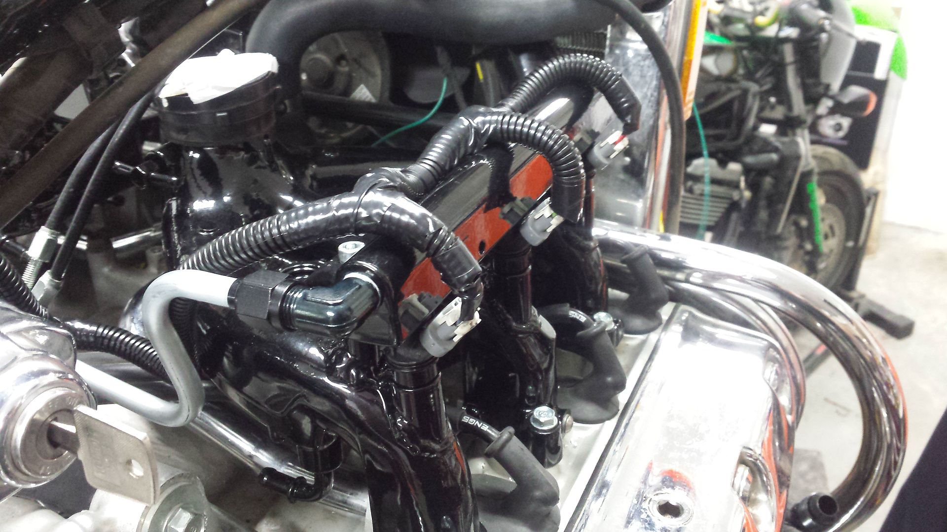

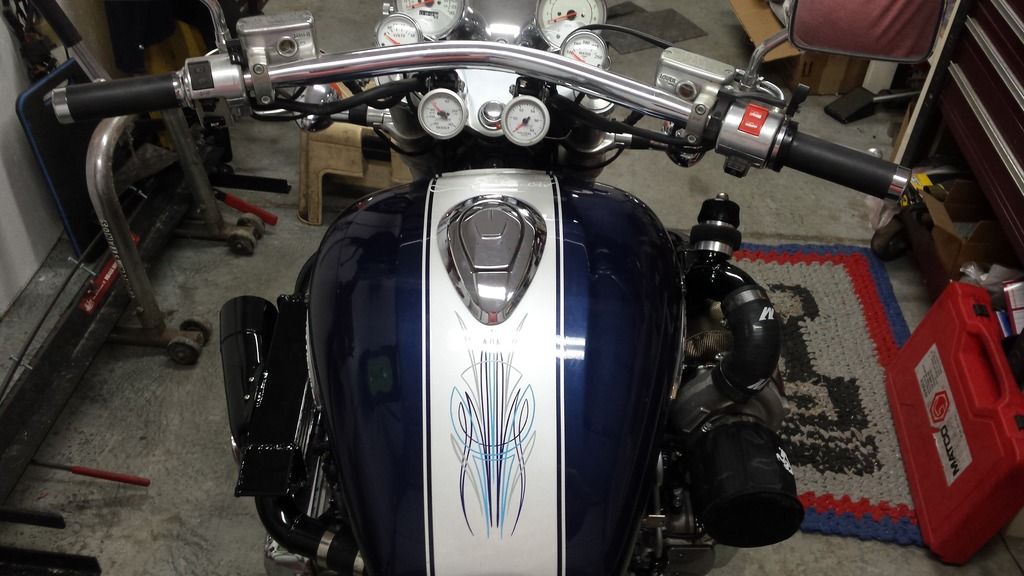

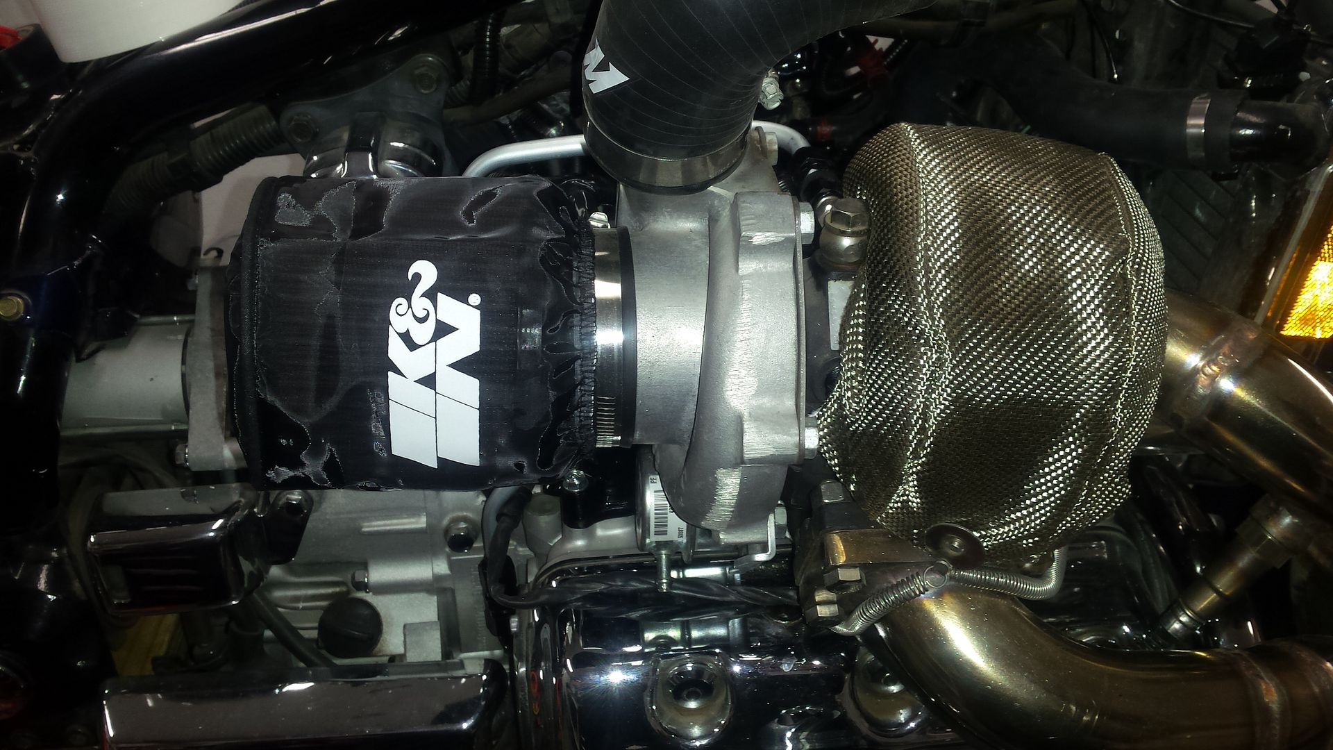

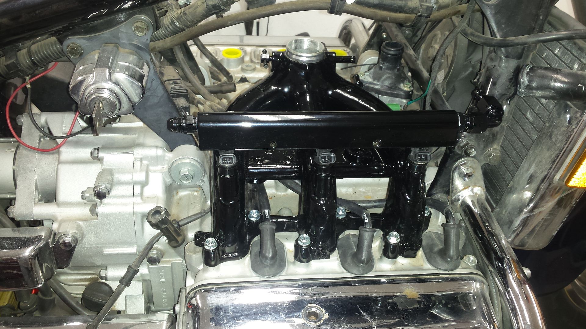

« on: April 17, 2016, 08:34:32 PM »

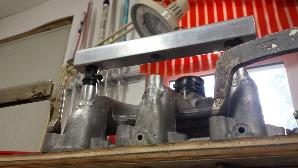

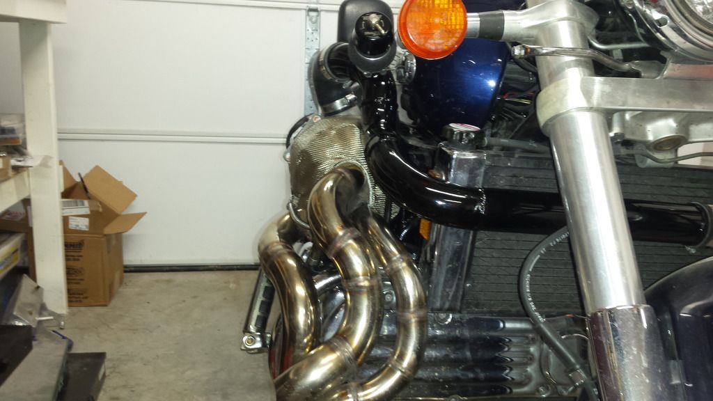

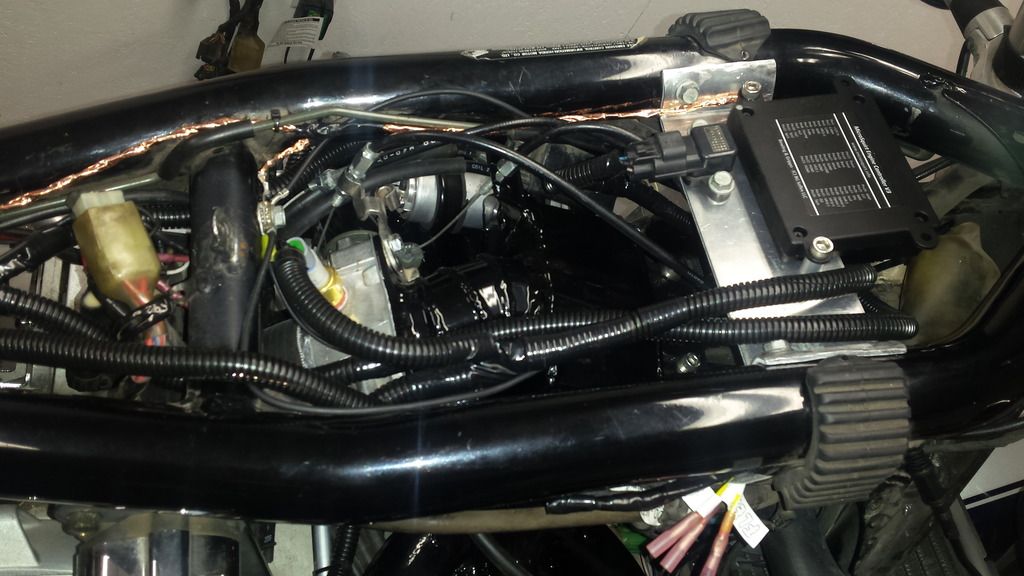

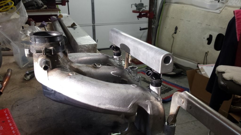

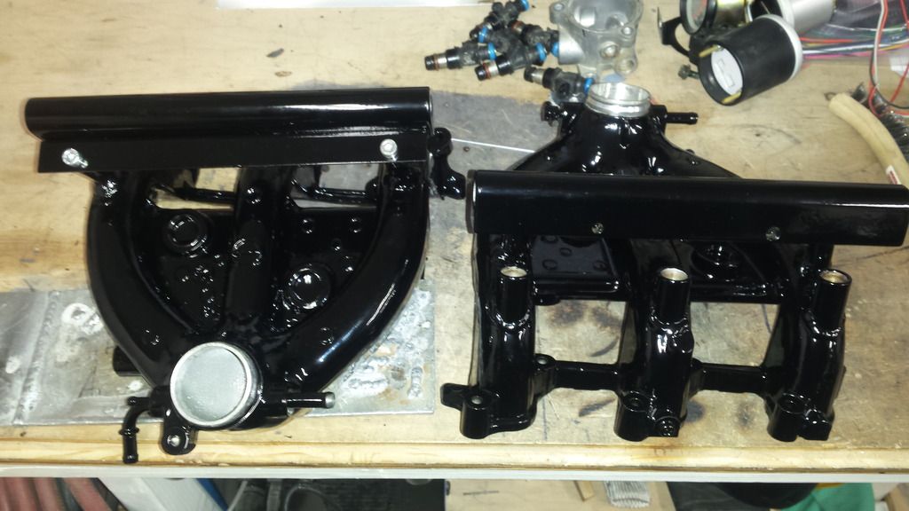

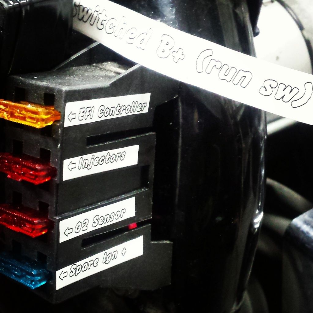

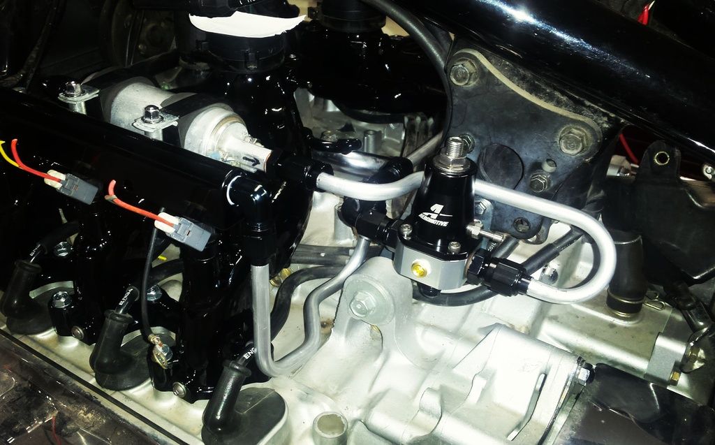

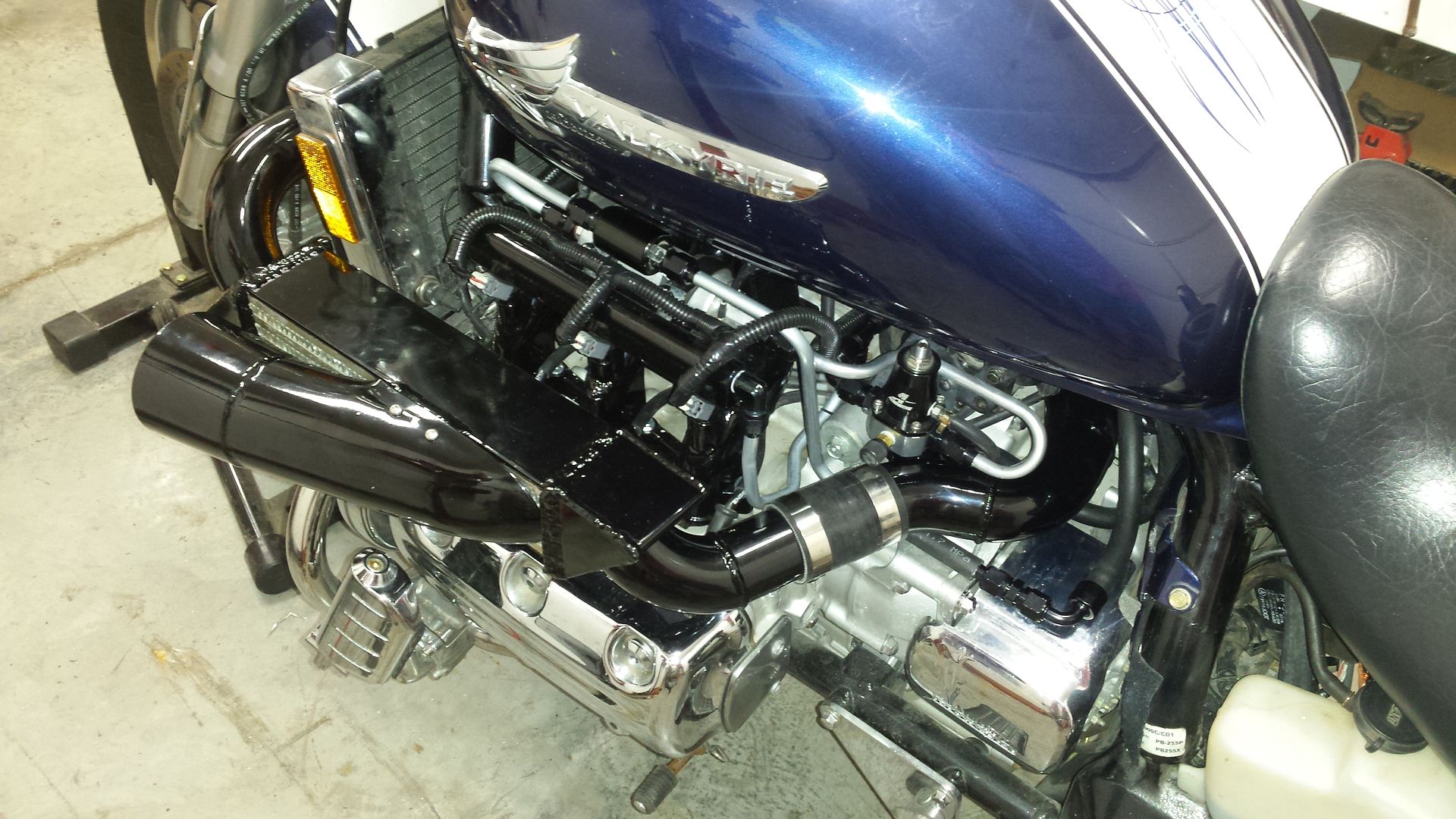

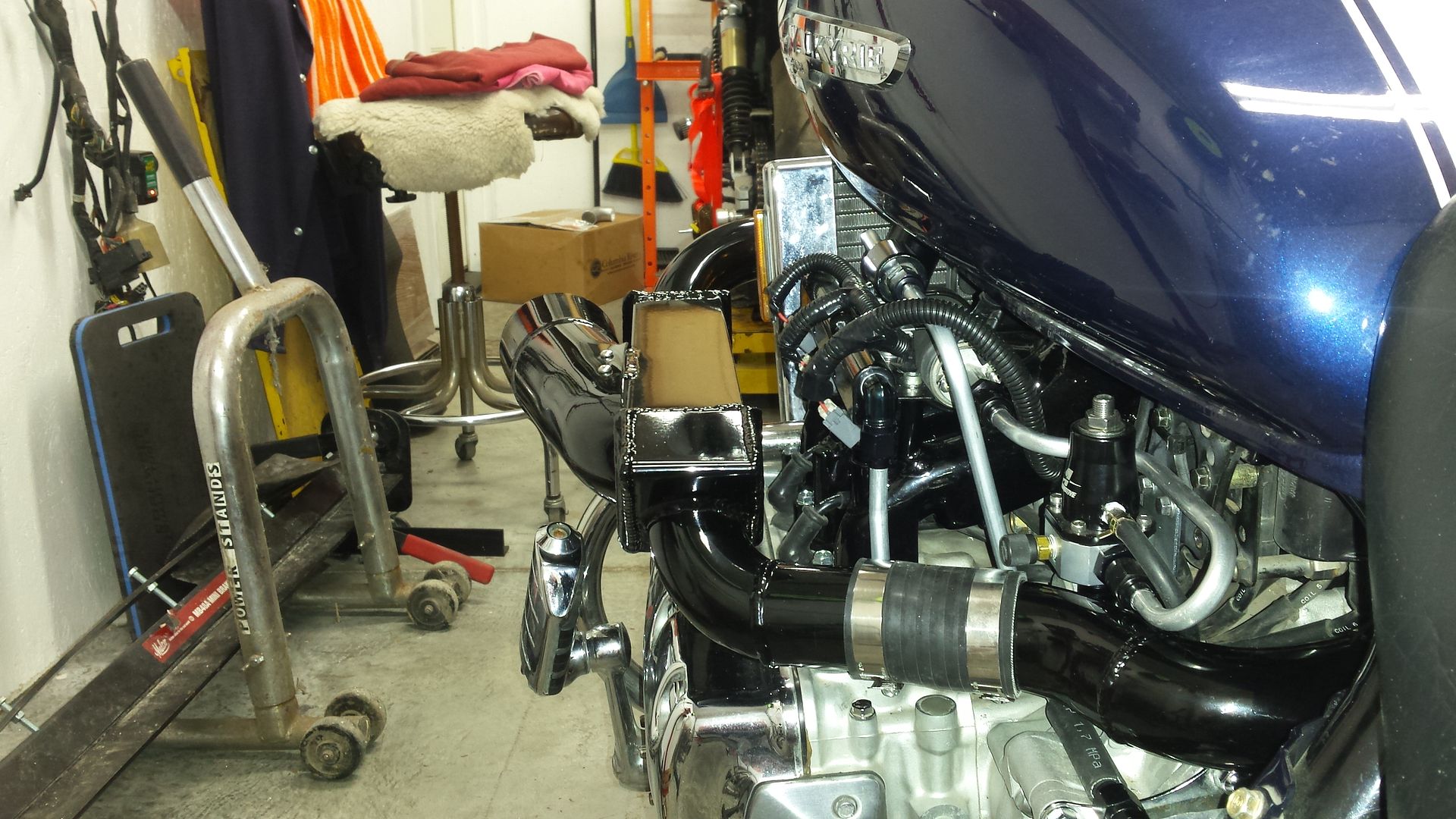

Hello all, it's me again.  I am back with another Valkyrie build, or transformation rather...I your not familiar with my earlier turbo Valkyrie build then you can catch up to speed here http://www.valkyrieforum.com/bbs/index.php/topic,73425.0.html
I just spent last hour transferring photos from my phone to photbucket just so I could make this thread, so I don't know how many pics I feel up to uploading tonight.  If anyone wants to see something that is not pictured just let me know, and I will post them up.

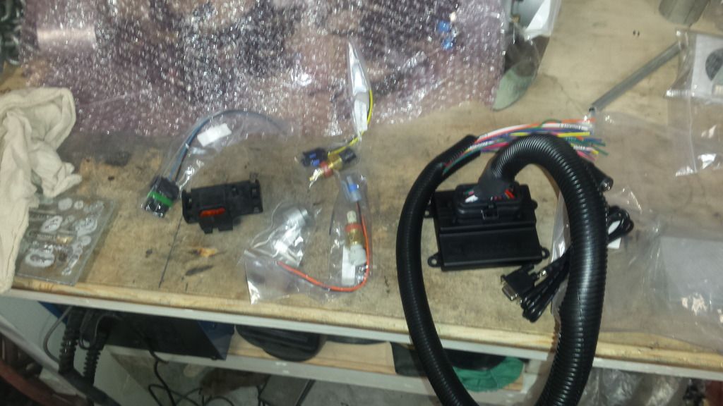

The electronic fuel injection is controlled by a completely programmable ECU called Microsquirt.  I only have the idle tuned at this point.  I still have alot of tuning ahead.  The engine was first fired up today.  We are running fuel contol only on this Valkyrie, although I can setup to control ignition also at a later date.  I think it was not necessary to control ignition on this bike.
I also changed some of the features from the first turbo install, I hope you all will enjoy the following.

« Reply #6 on: April 17, 2016, 09:04:54 PM »
Will this increase the power of the turbo bike ?
moodyvalk
Posts: 150
SE Kansas, NE Oklahoma
« Reply #7 on: April 17, 2016, 09:13:47 PM »
@ peak hp it might be minimal if any increase because I had the carbs set dang near perfect.
EFI will give consistency, reliablitly, and control of fueling at every load of the engine regales of altitude....so, is it possible to increase torque and hp in mid rpm ranges vs top end rpm? Most likely. And I can tune the cruising load range as lean as I would like to maximize fuel economy....

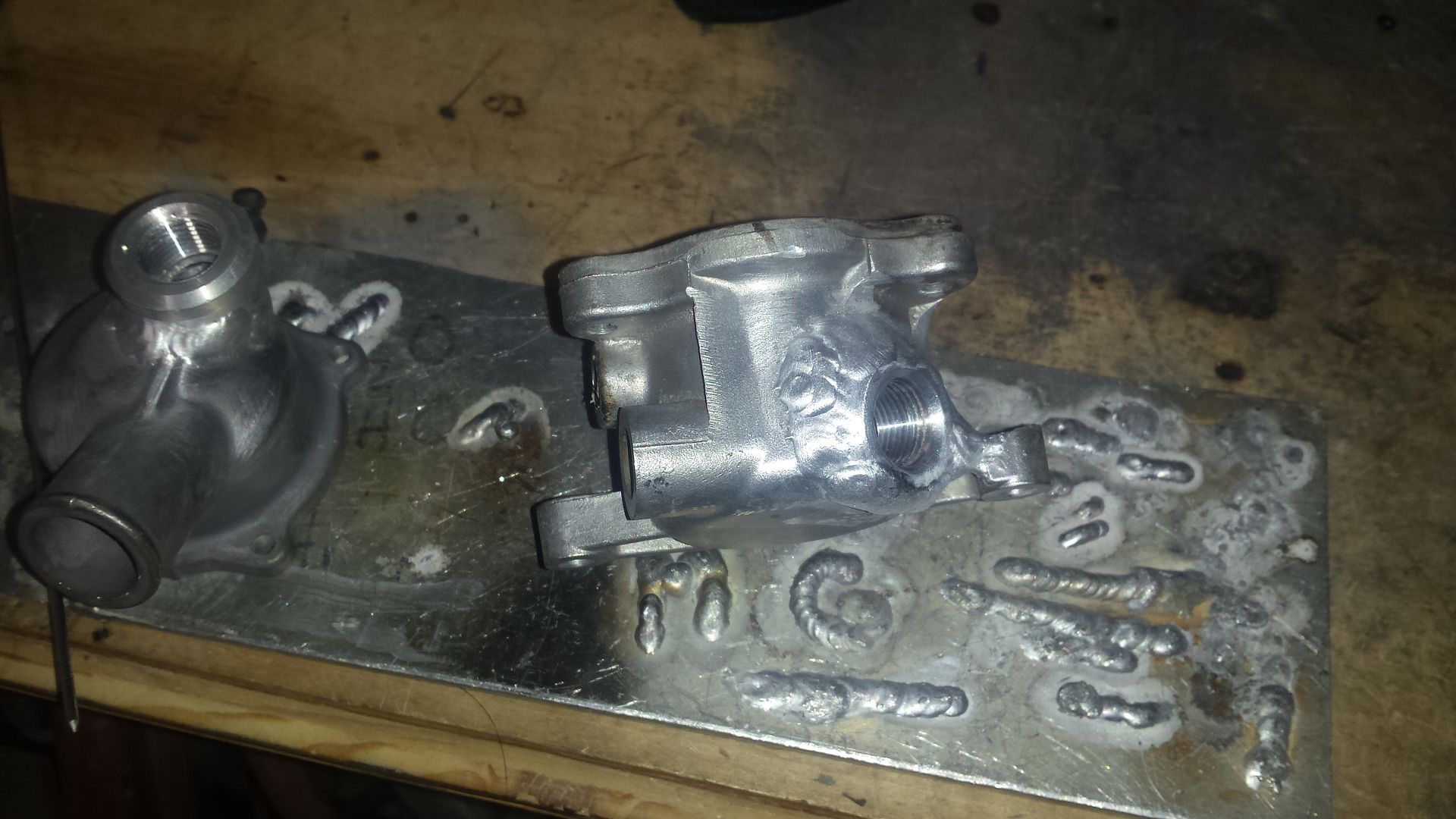

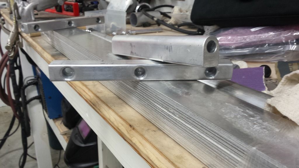

« Reply #9 on: April 18, 2016, 03:16:11 AM »
Nice heavy welds on the aluminum,,, do you Mig or Tig it?

« Reply #10 on: April 18, 2016, 03:20:33 AM »
That is some nice looking work . This is interesting . I could like a FE system on my Wing . Though it may have to much tupperware in the way .

« Reply #13 on: April 18, 2016, 07:46:46 AM »
Thanks, I TIG only.  The thermostat housing was a PITA to weld, thin cast aluminum doesn't weld well....
Thank you! I used Goldwing intakes for this build. They worked well, the upper plenum to could made to work in the Wing. Or the stock carbs could be modified to have a TPS sensor and you could use that setup...
