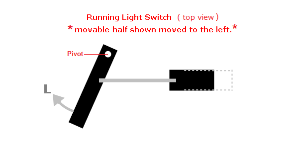

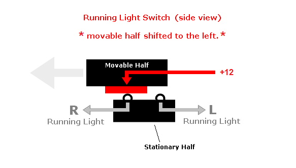

First, when you activate the turn signal, the running light on that side turns off, I assume to make the flash more visible. As many other bikes don't do this, I don't think it's necessary.
The running light in the activated signal shuts off so there's dark moments between each blink and like said causing the blinks to be more distinctive. But also, so you won't have both hi-filament and low filament lit up in the same bulb at the same time generating excessive heat, bad for the socket, etc. Understood rear signals are single filament bulbs.
For hazard lights which are left on longer, it's even more important that running lights (low filament) be disabled during hazard light mode for heat related issues. This can be done by a relay spliced into the running light's +12 wire at a point before it is soldered to the running light switch. The running light switch, itself, works something like the graphic below ....
The running light switch is ganged to the turn signal switch.
The running light switch consists of a movable half and a stationary half (like the start button). But note the running lights' wiring on the stationary half. Right is left, left is right and so on.
When you flip the turn signal lever in the left direction, the movable half of the running light switch also moves to the left direction tethered as they are to each other. The left turn signal is activated and starts to blink as expected. But becuz the running light switch is wired opposite in respect to the left and right signals, in the same motion, electricity is disconnected to the left running light. The end result is that the low filament (running light) shuts off for the duration that the hi-filament is flashing in the activated side's signal.
Side view below.
« Last Edit: August 11, 2016, 08:56:17 AM by RonW » Logged
