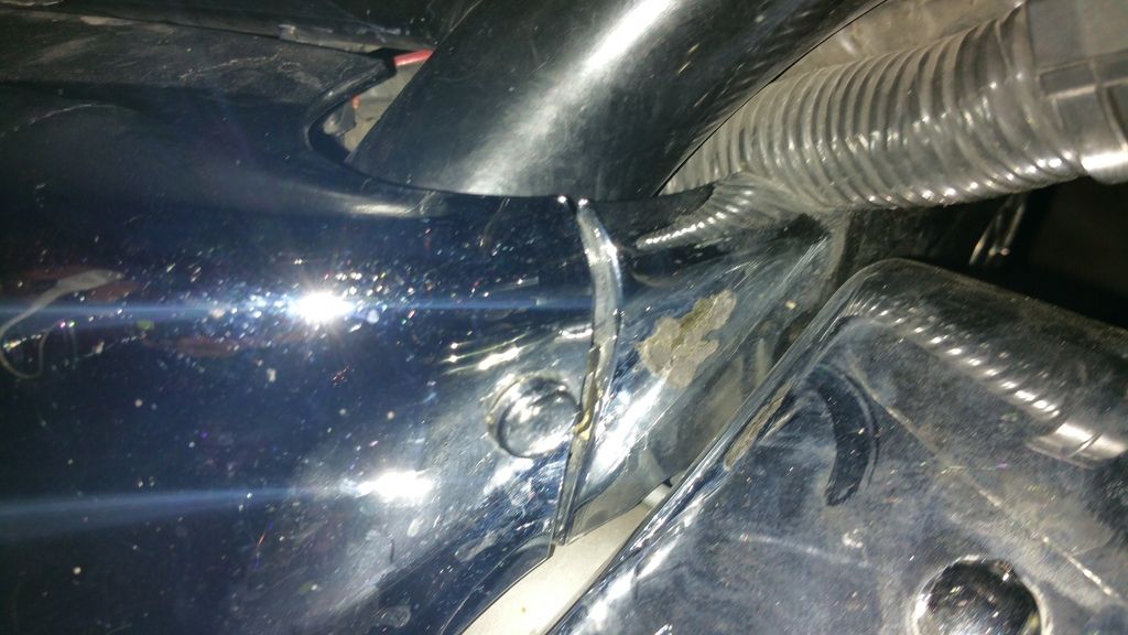

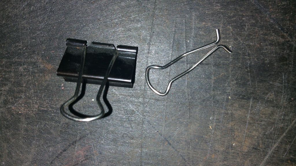

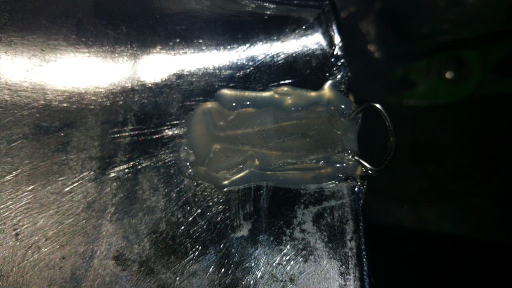

The tab on my side cover was broken and missing when I purchased the bike. the side covers had been screwed into the center cover and chrome caps over the screw heads. That's one way to skin a cat. I thought I'd try another since it was a bit inconvenient to remove screws when I wanted to remove side covers.

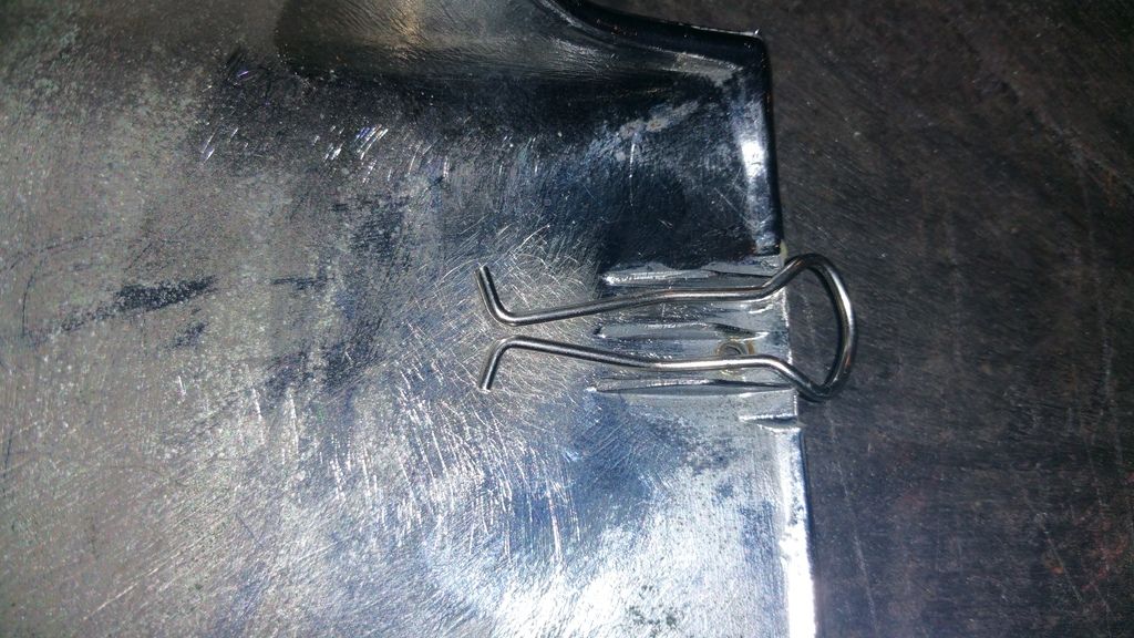

it really is an easy fix that takes about 10 minutes total.  just take a heavy duty paperclip and slightly bend to fit, lightly scuff the surface and hot glue it to the cover and you're done.
paper clip

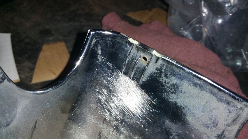

scuffed surface (you can see where it had been previously screwed together)
test fit

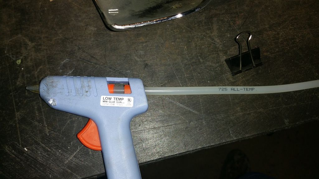

hot glue

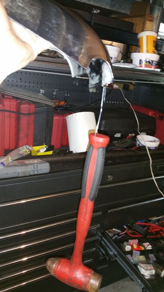

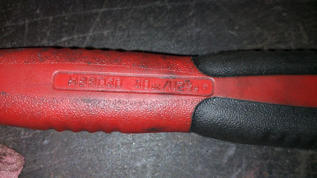

strength test with 40 oz hammer
Hot glue is an underestimated underused adhesive. I have found it more convenient to use and has a stronger bond than most 2 part epoxies. however in this situation with the engine heat and it being mid august we will see how it holds up. update to come

this is how it was originaly held on. there is a screw through the side cover into the center cover with a plastic button. chrome cap snaps over screw head onto button

Just did a bit of research on this glue. Application temp is 250-375F  softening point is 176F.  it will probably get soft but not remelt. if I have any issues I will clean out this glue and use ???? whatever I find in my basement I think might work. A big glob of rtv will withstand the temp.  I've repaired side covers on other bikes with legos and a soldering iron. duct tape will match the chrome close enough  2funny Grin

Got the other cover home to compare the tab opening.  Did a little clip bending , sanding and got it welded on with the Oatey's ABS (4 coats).
Sorry, I'm still pic-illiterate  ???

I'm very satisfied with the results I got.  Just like the pics above but I used ABS "Black" cement.

« Reply #39 on: April 07, 2018, 07:30:59 AM »
Got pics finally.
