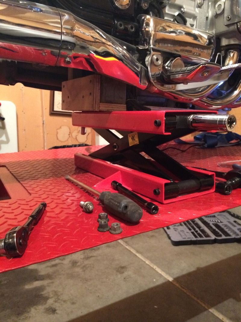

Misfit found a Snap-On electro-hydraulic car lift and thought of me since I have a shop and could adapt it to bikes.  I added a steel deck, removable loading ramp / rear wheel deck, a front wheel clamp and a Black widow scissors/platfom lift.  Of course I have my permanent installed lift adapter on all my bikes for the Black Widow to lift.  I don't know how I lived w/o this setup having used it for a while.  How nice to put whatever you are working on at eye level!  I can lift either end or both depending on where I put the Black Widow under my permanent lift adapter, remove the rear wheel deck/ramp to enable dropping the back wheel; put cinder blocks under the back wheel and lower the whole thing to lift the back wheel into position.  I zip the Black Widow up and down with a Dewalt drill & socket - really fast! Not clamp it in front for changing the front wheel, lift the whole bike off the deck with the Black Widow for cleaning the wheels...  Not sure I've explored all the versatility this setup has available.  And being a 6000 lb car lift with extra wide deck, how handy for placing all my tools at my fingertrips while working, and being totally solid - not the slightest wobble.  Yep this is the best tool in the shop!
Before this table lift I used Sears and Harbor Freight bike/ATV lifts, and axle jacks I modified to lift bikes with custom adapters - one jack was a long frame truck axle lift, to lift the bikes high, the other a standard car axle (punkin) jack modified the same way.  This table lift is WAY better!
BTW I sell this lift adapter in versions for use with a belly tank or not, cheaper directly to club members here, than I do on ebay. Available with paint or powder coat finish. PM or email or call; contact info at my banner ad above or http://www.horseapple.com

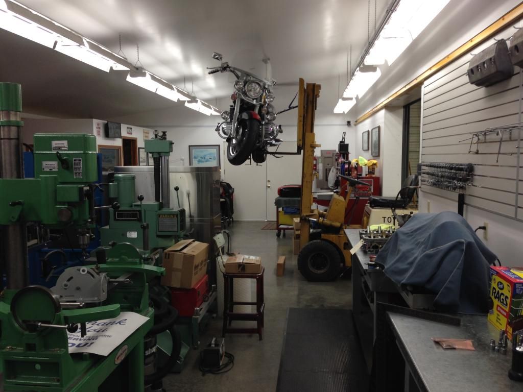

Here ya go Mike... not a table, but it works for me.
Redline Cool
Redline Cool
lol...perfect Cal, no bending down there! mmm...now, where do I store the forklift? 2funny

« Reply #12 on: January 14, 2017, 01:25:07 AM »
Redline Cool
Holy machine shop....
Is that your man cave, or is it your workplace?
Very nice, either way....
Both, I work from home.
