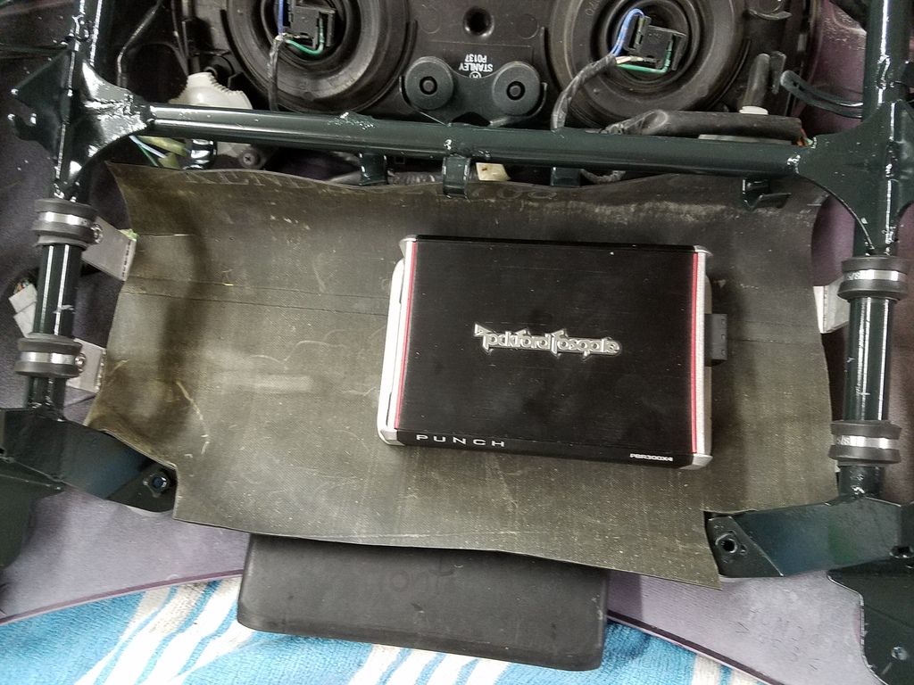

I just installed a 4 channel Rockford fosgate amp. The sound volume has increased and its clear. I'm considering adding a subwoofer inward facing on a saddlebag. For those of you with amp install experience can I share the sub on channels 3 and 4 with the rear speakers and adjust the gain on the amp to compensate for the needed extra power?

the unit is:
PBR300X4
Punch 300 Watt BRT Full-Range 4-Channel Amplifier
The Punch PBR300X4 is a 300 Watt full-range amp designed for compact systems. This efficient 4-channel amp packs a Punch in motorcycles, ATVs and hybrid-electric vehicles without sucking a lot of juice from your electrical system.
    MOSFET output stage
    2/4 channel input switch
    12dB/octave Butterworth crossover
    High level inputs
    Ultra compact chassis
    Variable 4-6 volt hi level DC offset voltage input turn-on control

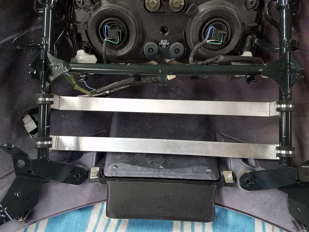

I made a bracket in the faring and mounted it with a  sheet of rubber to prevent possible moisture from reaching it.
