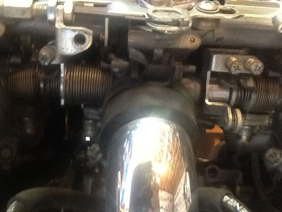

Not the D shaped ones. Maybe this pic will help.
Mine have a light blue on the screw head. I don't know if they all do.

Thanks guys--I guess MarkT had it right. Glad he stopped by.

Fazer, meathead is correct, don't touch the D head screws. There are five screws the you adjust, and they may not be colored, mine are not. The middle carb on the right side (while sitting on bike) has a idle knob, you don't adjust that one, it's for idle. All other carbs are adjusted to the vacuum reading for that carb. The screws are on the linkage. If you need further help, I can send you a picture of the above
