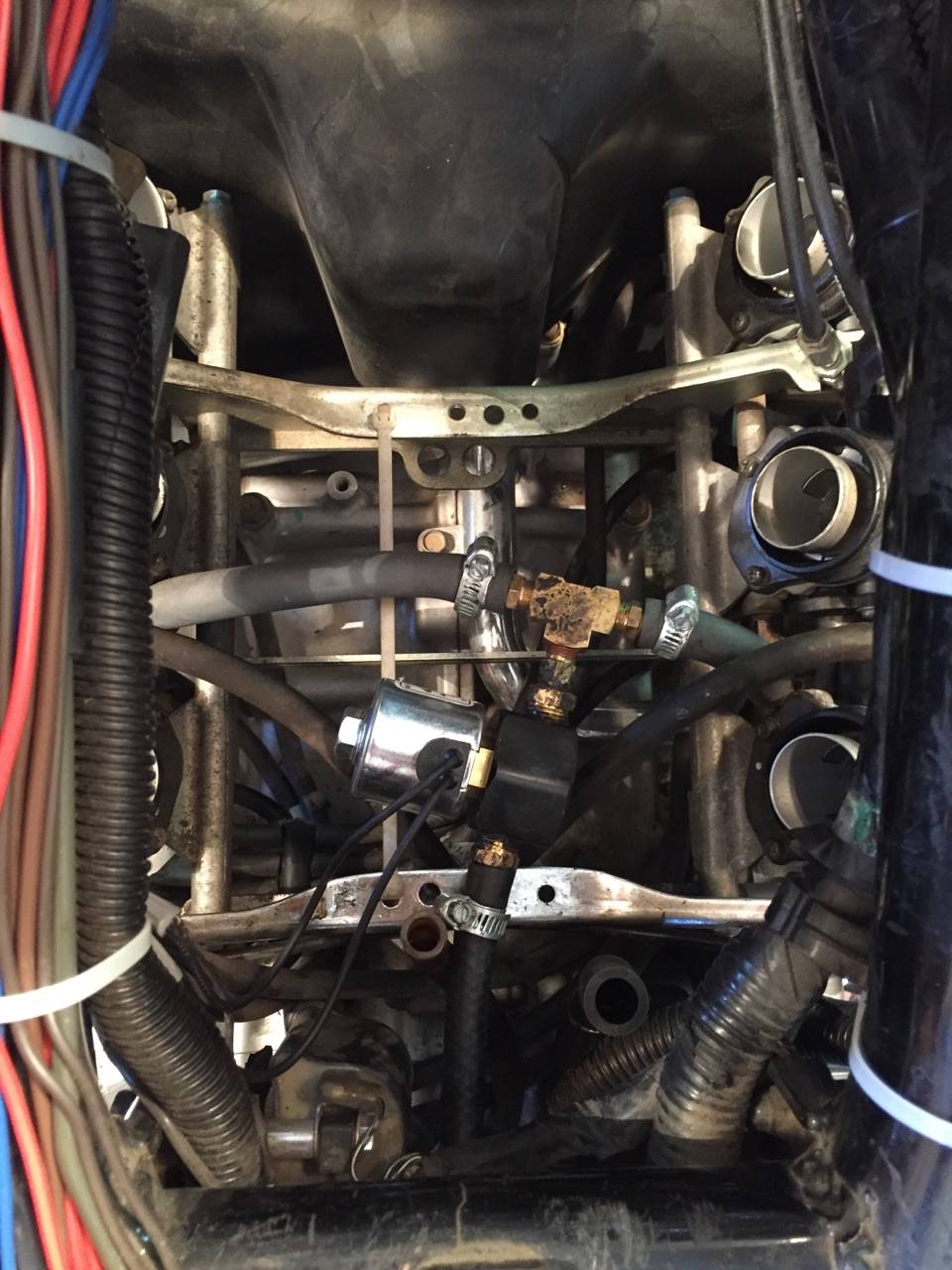

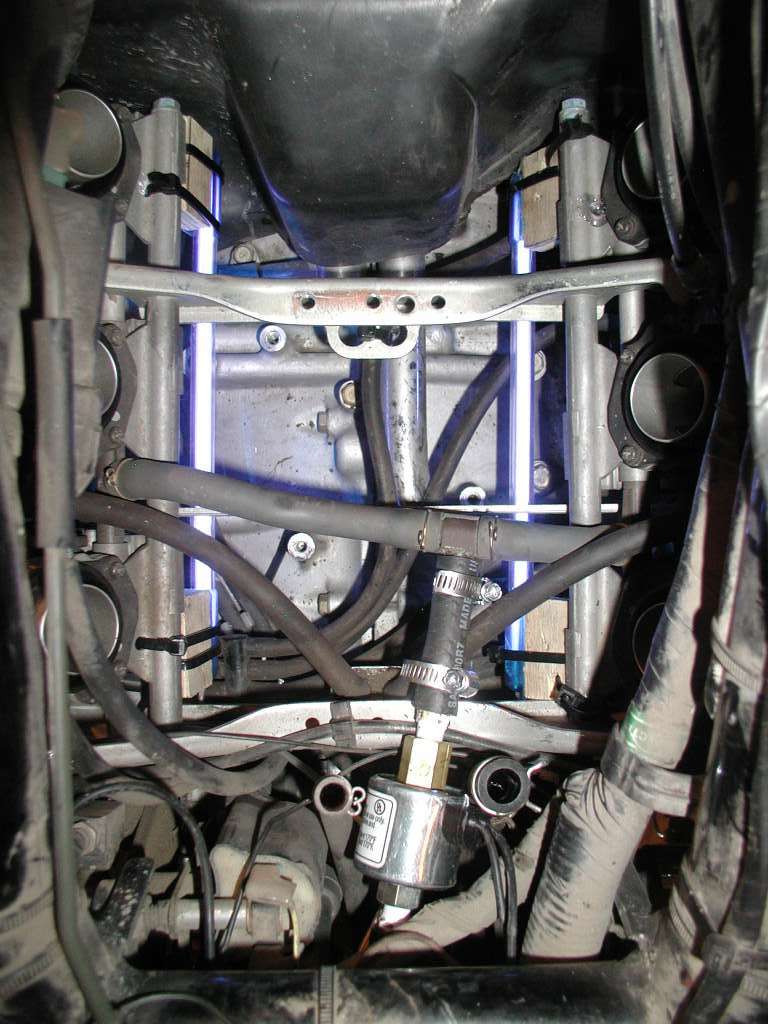

111 Dan-Marc.  This is on Deerslayer.
Larger 121 Dan-Marc.  This is on Jade. Notice the brass T replaced the plastic OEM T which enables the solenoid to be moved further North.

cheers, its the larger 121 that I have and was curious if it needed to be verticle like one I looked at (was taller too so got the tried and true) Did you secure mount the shutoff ? I thought it may come with a mount bracket but mine was just the valve in a box with no paper work or hardware ?
« Reply #3 on: March 14, 2017, 08:00:06 PM »
I couldn't find a pic. But mine is the model like yours, the same as Mark's second pic. Mine is vertical and back behind the carb brace. It's pretty firmly in place when all hooked up, but I did put a good size zip tie around it and the brace for good measure . I don't think it matters whether you do it horizontal like Mark's or vertical like mine. It just seemed fit better for me.
