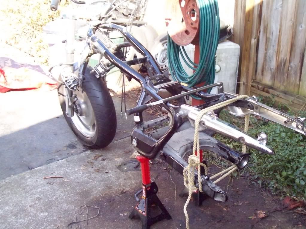

My bike after being stripped down.
I'm trying to remember, placed the jack stands on the side of the frames. Unbolted the engine supports. Removed anything holding the engine in place (wires, hoses), I used a floor jack to support it and roll it forward, a second person to support it would be helpful, so it doesn't fall off.
I had a flat moving dolly, and placed it on there to work on it.
