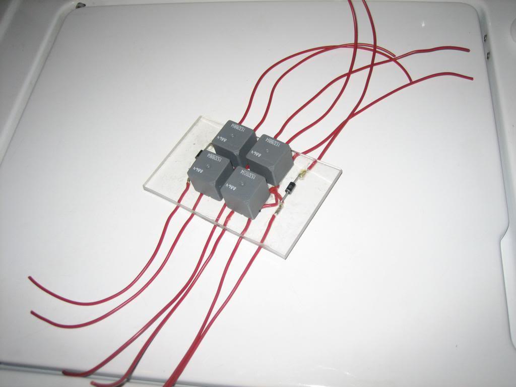

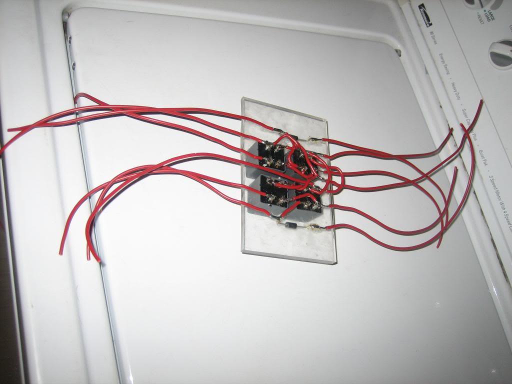

I've done all of the above WRT red rears (except post pictures of moobs. That would get a fella banned.).
My first Tourer had a relay-based converter that I designed, and which allowed all three 1157 "hi" filaments to act as brake lights. This was switch defeatable and used dual-contact sockets.
Arguably, the simplest way to get a red lens, two-filament rear setup is to use a set of front signals on the back, running the extra turn signal wires from the headlight down the frame and into the right side cover area. I built a harness which conveyed those signals to the rear light assembly, following the OEM wiring channels in the fender.
Lenses were the Kuryakyn deep-dish bezels, which work on the 2000-up (single retaining screw) turn signals.
My '01 I/S employs a run-stop-turn module and single-contact rear bulbs, and my second ('99) Tourer just uses the red lenses - but it wears the I/S trunk and those lights have been converted to a stoplight function.

This circuit will power run-brake-turn with 1156 sockets. All you need is red lenses.  I ran clear lenses with red LED arrays.
