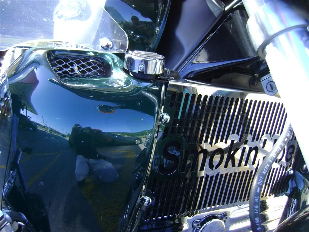

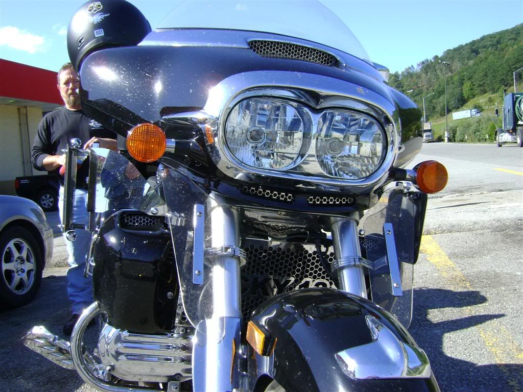

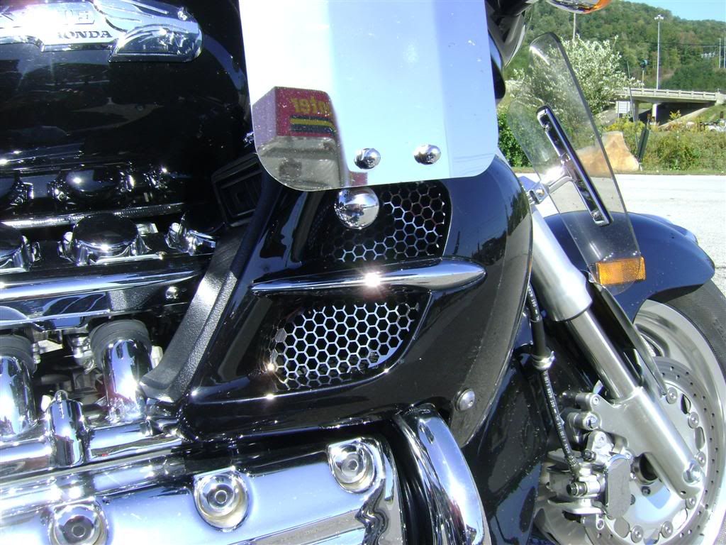

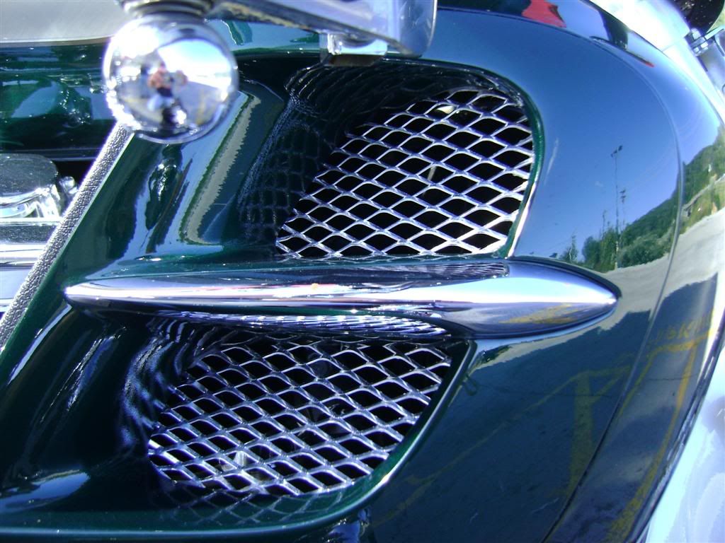

« Reply #9 on: October 24, 2009, 07:10:35 AM »
Here's mine Charlie The Sculpture made these but from what I hear some hard times have came Charlie's way  Undecided
These are what Lucky 13 has he had these custom made at a fab shop to match the cone grill he got from Carolina Bike And Trike.

« Reply #10 on: October 24, 2009, 09:04:27 AM »
I remember seeing the ones on Lucky 13's bike on our ride to Fall Creek Falls, they are the nicest ones I have seen yet.
