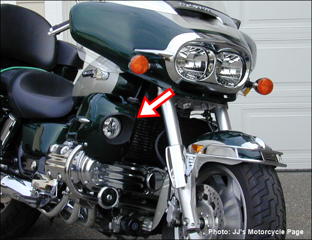

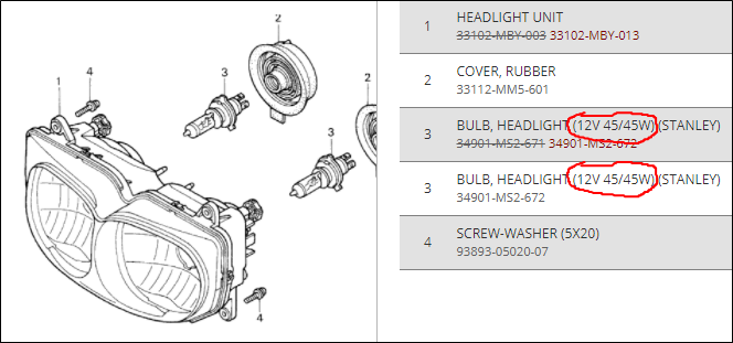

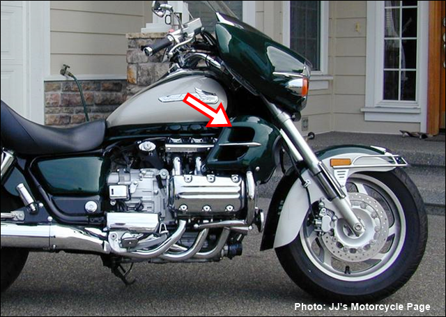

What's this light pod thingie in the pic below (arrow). I thought all Interstates had them. From the side it looks like an Interstate radiator cover, 2nd pic. Obviously, I don't own an Interstate.

« Reply #10 on: November 14, 2017, 03:21:05 PM »
What's this light pod thingie in the pic below (arrow). I thought all Interstates had them. From the side it looks like the standard radiator cover, 2nd pic. Obviously, I don't own an Interstate.
That was an option which is no longer available. Last used set sold for almost $500.00 and the only part that is needed but not available are the rubber boots that go between the pod and light fixture. Probably work fine but if I am going to spend that amount of coin it will be on a more up to date LED set up.

« Reply #12 on: November 14, 2017, 05:13:08 PM »
That explains things. I had thought with all the headlights on the Interstate why wouldn't the bulbs be adequate, I mistakingly thought they came with 4 headlamps.

I really wanted the stock extra lighting .....
Especially with the 45/45 bulbs. Low beam 45 watts. Hi beam 45 watts. Might as well just have a single filament 45 watt bulb. What's then the purpose of the high/low switch?
To switch the pattern of the light from wide/short to narrow/long, either way you have 90 watts of light.
The filaments are located in different positions so as to cast the light in different areas.  That is why when you go to an LED bulb on the interstate you need one that conforms to the H4 standard and positions the LEDs in the correct positions.  If you get cheap ones the light will blow out all over the place.
