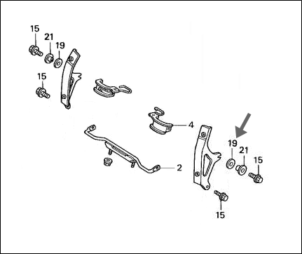

Well, I finally replaced my original windshield on my 99 CT with a Clear View Windshield...Got it all back together but am a little amiss about the upper bolts, collar, and the rubber washer on each top right and left upper brackets...should the bolt, collar, and rubber, be on the outside of the windshield bracket and the bracket be flush with the upper brackets....or should the collar rubber, be between the windshield bracket and the upper bracket...I don't think it would make too much of a difference but would like to know the proper way to install that small collar rubber...!!!

Does this answer your question ?
http://www.valkyrieriders.com/shoptalk/GL1/gl64.jpg

Bone...Thanks...it was late and I tried to just use my memory...Guess that is why Heavenly Father had us keep records...!!!

Videos are even better. A 5-minute clip would record every bolt on the bike. I don't have an Iphone, smart phone. Anybody know the best rubber washer to replace item 19 below? Mine's not Oem and seems every few years, it falls apart and has to be replaced.

They're about $2.50 or so Oem, but don't know whether they last that long. I take the windshield off when I wash the bike, but leave that top bolt on along with the washer and maybe getting the washer wet with suds is deteriorating it. The attachment for the top bolt is slotted for safety.

I'm with you Harryc...Still have the original rubber washers and they look good...also, only remove windshield for maintenance or as necessary...I use cleaners too...not water...unless it is raining...19 yrs old and still looking good...!!!
I went to Home Depot and picked up a small box of faucet washers. They work great and are durable. Just about 10 years on the same two and have plenty on hand.
