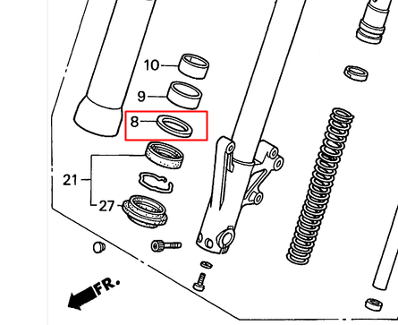

RonW
Posts: 1867
Newport Beach
« Reply #8 on: February 20, 2018, 01:04:34 PM »
Haven't had to replaced the seals on my Valk yet, so haven't tried this on the Valk forks. If you buy an extra backup washer (8, below), and place the metal washer on top of the oil seal, it's then easier to use the pvc pipe to seat the oil seal becuz the pvc will be hitting metal with the oil seal below it. Pvc material isn't that hard that it'll mar the rubber seal, but it's that the washer makes contact to almost the full the surface of the oil seal. The backup washer is just the right size. Some people even stack two pieces of pvc pipe on top of each other, and use the top pvc pipe to pile drive the pvc pipe below it.
