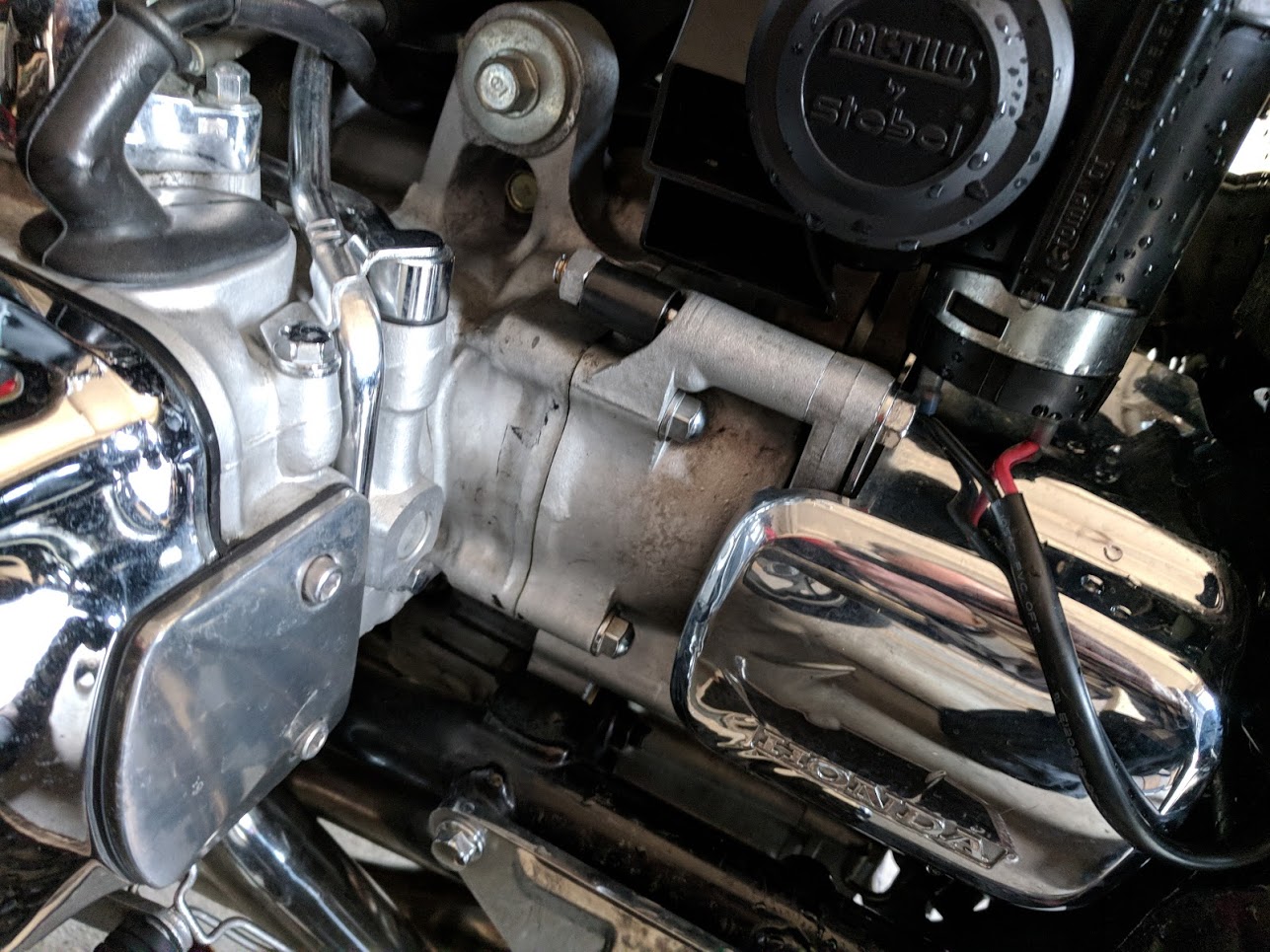

Pulled my bike out from its resting place today. Looks really sad. I’m sure I’m going to be kicking myself for not meeting up with BigBF when he came through Kentucky.  The battery is dead, wouldn’t even accept a charge.
Not been licensed since January 2015!!
It will take me a couple of days just to clean so I can bear to look at it for more than a few minutes at a time.
Carbs are going to need to be rebuilt for sure and a complete rear end service too.
I’ve got a new product to try on my wheels that supposed to bring them back from the dead. I’ll report my findings as I have a rear wheel in desperate need.

She is still good looking...
May I ask what happened?
Mine I/S was collecting dust for 1 year thanks to 2 broken alternator's bolts.

How did you get the broken bolts out ? I've got one broke now can't get a drill to it to drill out . It's been broke a couple years the other two bolts have been doing their job and I still ride it but I'd like to get that broke bolt replaced.

@smokingjoe: since I broke 2 of the bolts (unlike your bike that was only one) I drilled through one of the bolts using a dremel (took hours and a few days). When I was done with the first, I just gave up on the second and got myself a new bike (Honda ST1300).
One year later, I brought the bike to a Goldwing specialized shop (WingNut@Fairfield - CA) and let the pros do their magic. They modified a drill bit for the job (made it shorter) and used one of those short/90 degrees driver/drill.
They drilled through it and used new bolts with nylon collars, it looks ok and is functional.
In your case since you still got 2 bolts, I wouldn't go through the hassle of trying to remove the broken bolt.
