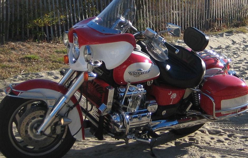

The Valk interstate radiator hose slinky is a good functional and nice looking part. (the link is for '99 Interstate)  I think it's aluminum (if not stainless).  Not high gloss.
It can still be had.      # 19 19123-MBY-000 PROTECTOR, RADIATOR HOSE  $27.93
https://shop.procaliber.com/oempartfinder.htm?aribrand=HOM&arian=MOTORCYCLE#/Honda_Motorcycles/GL1500CFA_(00)_VALKYRIE_INTERSTATE,_USA,_VIN%23_1HFSC410-YA100001/RADIATOR/GL1500CF-00-A/14MBYXE1AMBY4F3300AA
The hoses are here too.  I cannot swear, but the hoses are likely the same parts for all models and years. The way to be sure, is log in on your model and year, and compare part numbers.
I doubt you need Honda clamps, but I wouldn't use the old ones.
This is an old one. (Pinwall cycle). (An old slinky could be cleaned up.  An old hose can be thrown away)
Big Bike Parts (Show Chrome) used to make a chromy bolt on hose cover.  They looked very nice, and they often leaked badly and were unreliable.
Reversed image.
