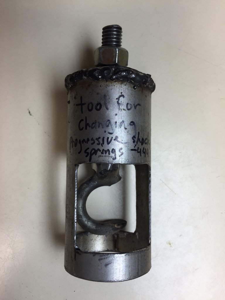

My Tourer was scraping every once in a while using Std. springs so I picked up a set of I/S springs and installed them myself. Did so using a homemade shock compressor. Problem solved and don't have to crank the setting all the way up either.
http://vrcc.photostash.com/vrcc_18944/S3500182.jpg
If interested I can dig it out and give some specs on how to build it.
If you put the bike on a lift there is no need for a shock compressor
I was thinking the same thing, but I think John is saying he swapped IS springs ONTO his std shocks.  You'd need one for that job.
I didn't think the Showa's were rebuildable ?

« Reply #23 on: January 04, 2020, 07:42:30 AM »
Well, I heard the same thing, but I'm not sure changing the springs without messing with the hydraulics is  a complete rebuild.

« Reply #33 on: January 05, 2020, 11:35:53 AM »
I made this tool to change springs.  Note, changing the springs isn't enough - the dampers need changing too.
