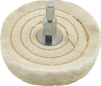

Then, you can polish.  My best results have been from using different cut bars of stick paste on hard cotton buffs on a power drill.  Start harsh, and go to milder on the stick compounds.  With the drill, you must be careful not to rub the arbor on the wheel as it gouges and will take a long time to buff out.

If your wheels are really crummy, after first scrubbing, I recommend a bar paste and electric drill with 3 or 4 inch hard cotton buffs, before a final polish.

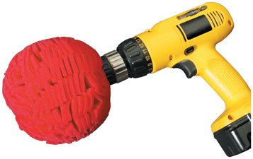

I've used this Mothers foam powerball, but it is not up to the task for removing hard crummy corrosion, more of a final polish buff.  The soft foam will not stand up to prolonged hard work.
