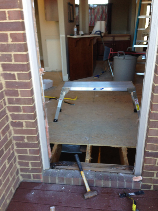

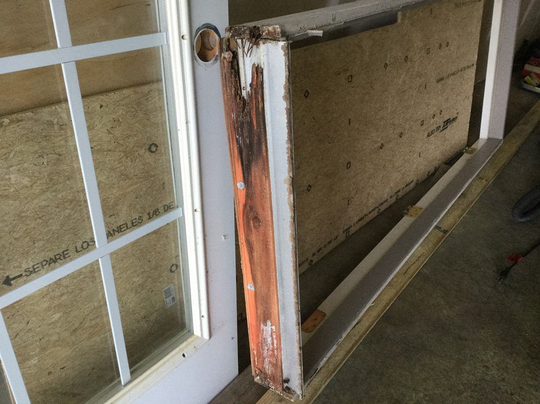

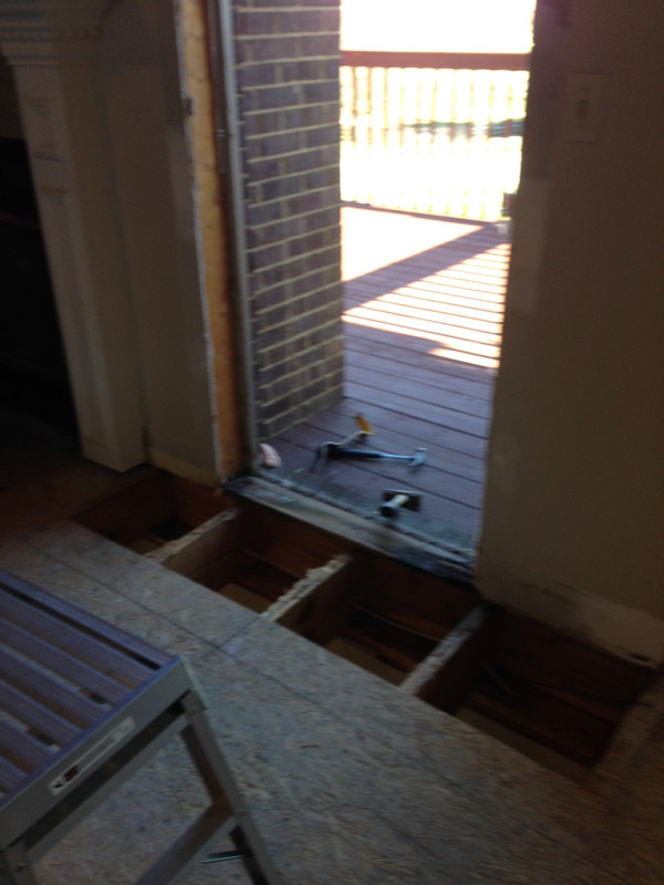

Well here is a start, I had one other leak to deal with that I have mostly addressed.
This the bottom of the back door leading onto the deck
I cut out an area of the floor about a foot wider on each side of the door and about 18 inches into the room. This was an old leak that not only rotted the door jamb but the subfloor too.

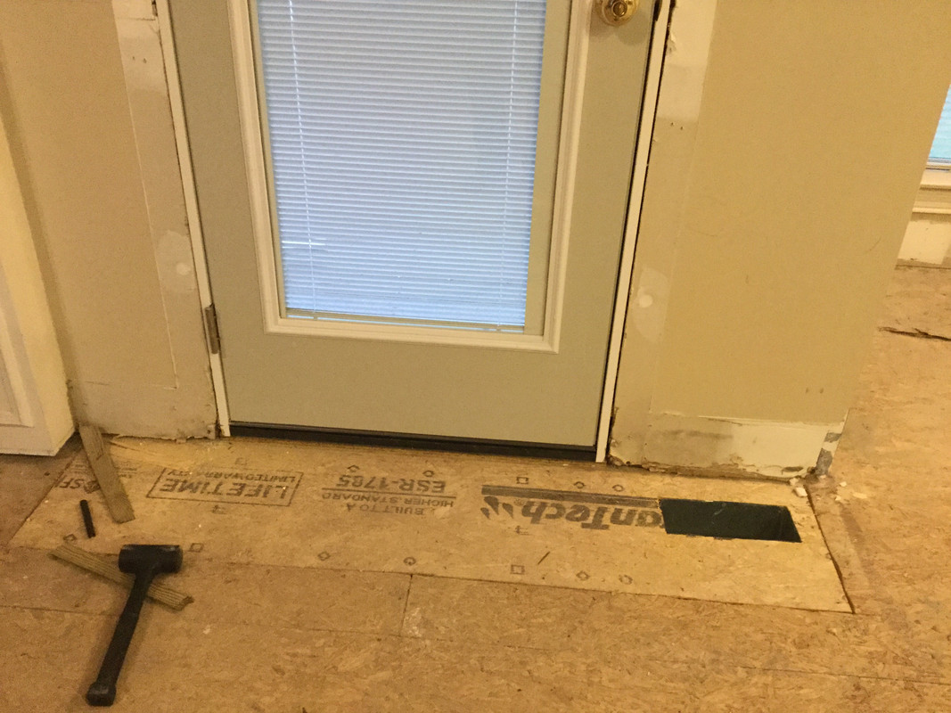

This is the flooring replaced and new door installed. Once again the reason this was not apparent was there was tile on the floor just inside the door.
The roof leak I’m dealing with is on the opposite side of the mantle shown in the last picture.

  The main contributing factor for the door leak was the fact that the brick sill under the door is installed flat. There is no slope away from the door. Poor caulking also contributed to the issue. My long term plan will be to build a cover over the door to keep direct weather off the sill.
Is it possible/practical to grind the bricks to create the desired slope?  Or perhaps to knock those bricks out and reset them at the right angle?
 Wouldn’t want to grind on the bricks as it would alter their appearance dramatically. I could knock the bricks out but the deck floor is somewhat in the way so I would need to wait for better weather conditions to tackle something like that. I like for my exterior doors to be protected by a roof or overhang where possible and the design of the back of the house will allow me to do just that without too much trouble. My front door faces the west and is well protected from the prevailing winds. It’s about 8 foot back under the “porch”
