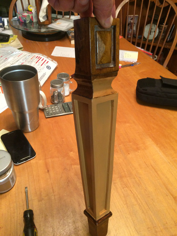

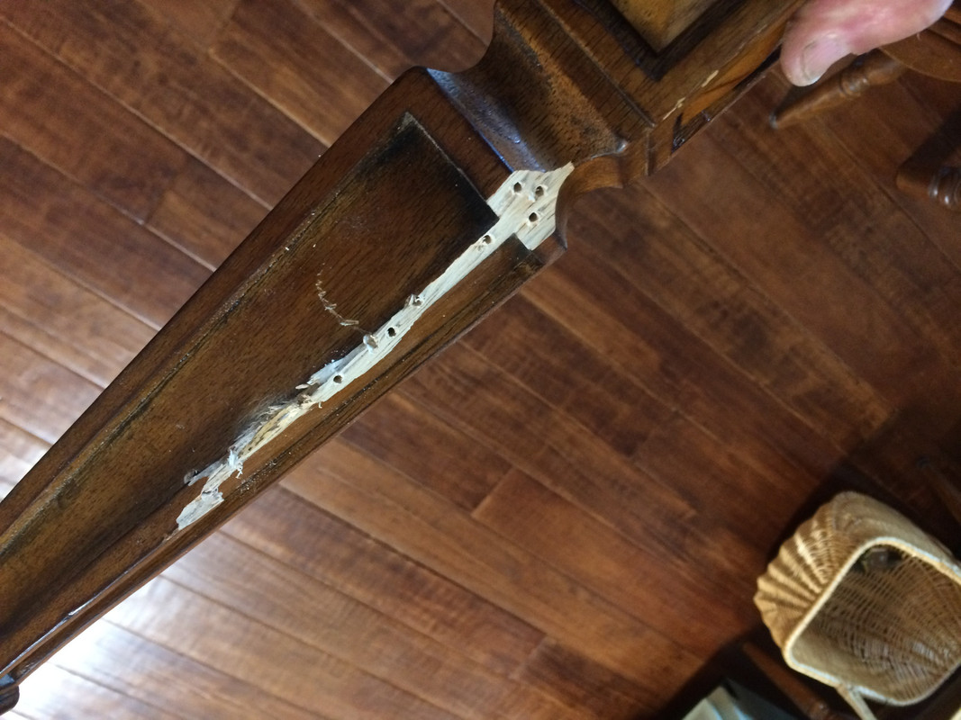

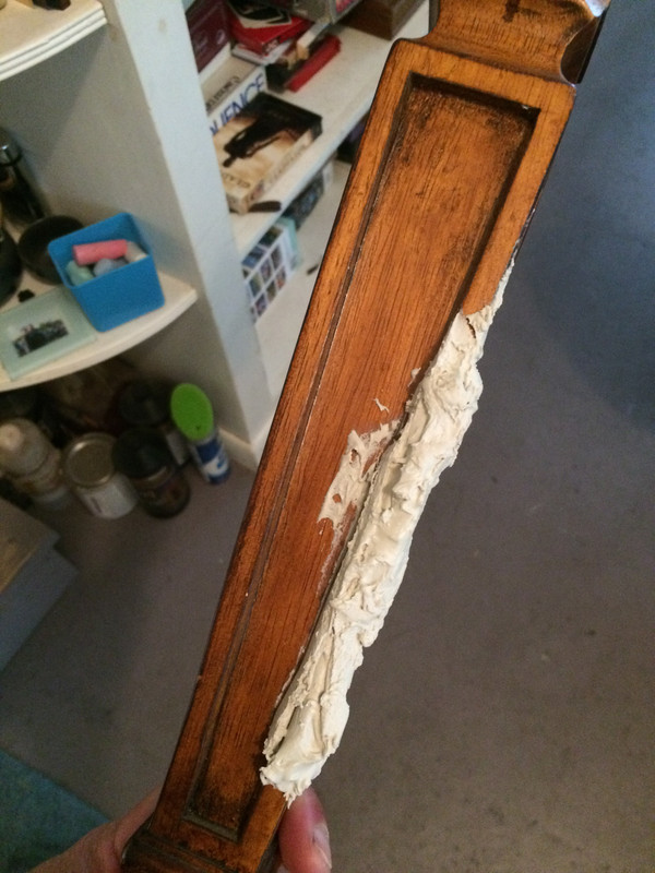

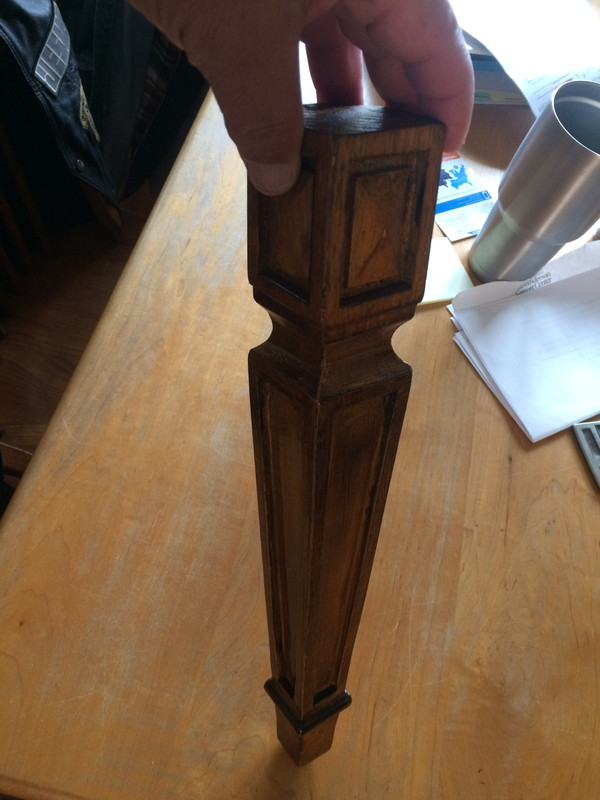

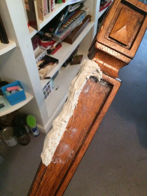

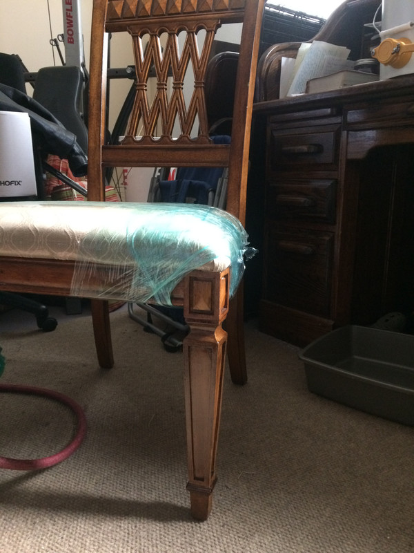

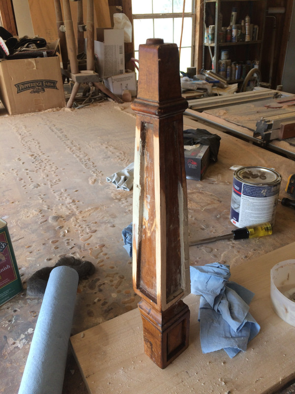

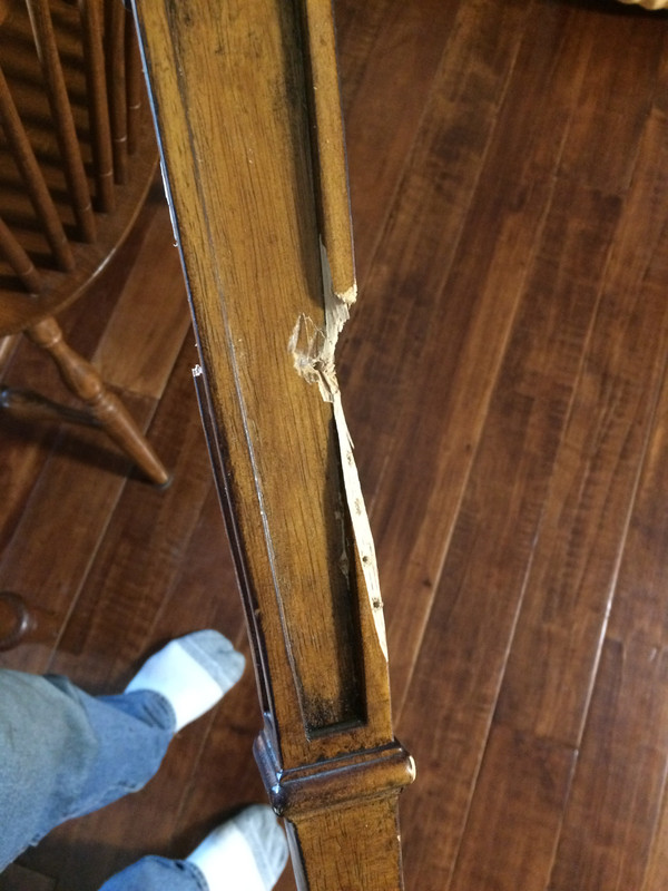

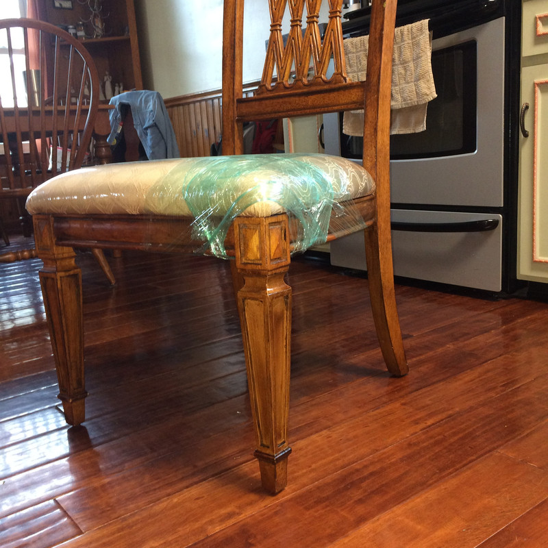

I have been riding, but today Ive been working.  I fix a lot of furniture for moving companies that damage lots of furniture.  So I guess I have been getting better at it.
My guy brought me this chair, the leg got squished in the power lift of the truck.  Whole profiles gone.  YUCK
So it was wood putty time
Then sand and carve it back to original shape and paint a base coat
Then stain and polyurethane.....back on the chair, magic
That was hard to get the fixed leg to look old like the undamaged one....its pretty close

Nice job on the repair. I have to do that once in awhile, also. Do you have a pic with the final finish? That's what gives me the most headache....
DOH, it just popped up...
Nice job!

Thanks...
Heres another of the finish

My mover guy picked up the chair a few minutes ago and he was blown away. Didn’t even flinch at the price. I’m too cheap. Lol
