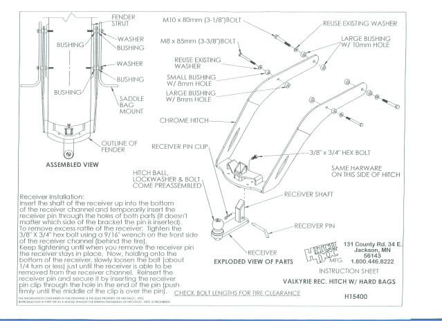

Hitch Doc w/receiver (hidden) - Part # 15400 - Seeing as how I haven't got it mounted yet I thought I might as well take a couple pics

I like the looks of the hitch doc. In the pics it looks like all that holds it on are 4 bolts that hold the bags & fenders Is it strong? the hitch looks great but those 4 bolts look kinda small to me.
Stronger than it needs to be. I pulled my trailer with 14 inch tires on it for 10k miles with a hitch doc, and did not even know the trailer was back there. Best Hitch made.

« Reply #16 on: December 12, 2009, 08:48:50 PM »
There are two 10mm dia. bolts towards the front and two 8mm dia. bolts to the rear.  With the shear strength of the bolts and the thickness of the hitch you should be able to pull a boat trailer.
I will be mounting my Tsukayo hard bags to them over the winter and to allow easy removal of the bags, I plan to have a couple intermediate pieces machined up at work. They will be mounted thru the two holes in the hitch on each side and then mount the saddle bag brackets to tapped holes in the intermediate piece(s). That way I can remove the bags (for whatever reason) without disturbing the trailer hitch/fender strut bolts.

I just bought one from the classifieds and it did not come with directions or bolts. I would like to see a close up if any one has one. Thanks
When I get some time I'll scan the instructions I have and post it.  Also, You can notify Hitch Doc for hardware and see what they say.
later ....
VRCC # 30938
Sodbuster
Posts: 1159
« Reply #27 on: December 13, 2009, 02:29:17 PM »
OK .... here you go
http://i89.photobucket.com/albums/k210/sodbuster_gl1100/HitchDocInstructions.jpg
VRCC # 30938

I have the Hitch Doc receiver type hitch on my Interstate.  I love it but it was a night mare to install.  I followed all of the hints that are posted by members.  However, I had 1 bolt on the right side that messed up the threads inside the fender when I removed it.  I had to remove the truck and fender to rethread the hole.  After that it went back together pretty easy.  Also had to fabricate some other parts because my bike has rails on the bags.  I use a rack when the wife comes along because I do not tow the camper.  I purchased the rivco rack from wing stuff and it works great.  I also purchased the optional led light set that you can add to the rack.  This allows you to remount the plate so it can be seen as well as having lights that are now visible.
I did not buy my hitch from Hitch Doc directly because I was able to save money.  Do not remember the company name but the person is Marty and his email is marty@tmcil.com his phone number is 708 479-5100.  He was very helpful with the entire sale.
