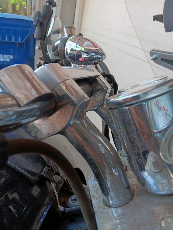

While they don't seem to be available anymore, I installed Show Chrome risers, a few months after I bought the bike, so almost 11 years ago. No problem with cables, besides a little change in routing:
Please excuse the crud on them; I haven't had a chance to polish it since my last wet ride.
That gauge is 3-1/2", for reference.

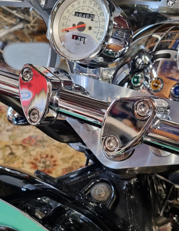

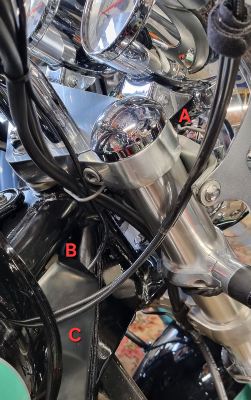

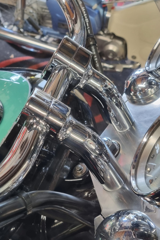

It's now all set up. The main problem was the throttle sticking open if I turned full lock to the right.
The only way I could prevent that was to slacken off the cable adjusters to their maximum. The throttle now is fully functional on both locks but I have to put up with throttle slack of between 8mm and 10mm.
This pic shows that the cable would originally have gone around the front of the fork at "A", then through the cavity at "B". It now goes behind the fork and enters at "C".
The last two pics show the Baron Kickback Risers...

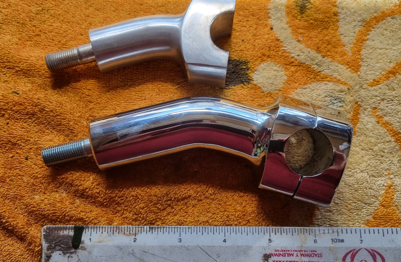

....and finally, the difference between the oem Risers and the Baron's .....
