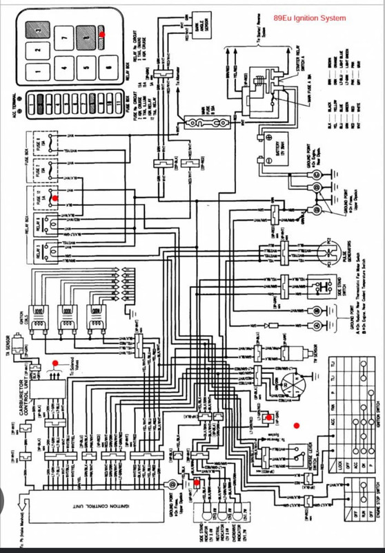

Hi Team, I have a Valk GL1500 1999 and I'm struggling for a spark, I've traced issues to the ICM and I want to check all leads as each cable coming from the ICM isn't numbered unlike some of the schematics I've seen. I found one schematic with all the outgoing cables colour coded but it's not clear.
Does anyone have a clearer version for my year?
The Bank Angle Sensor and sidestand switch was removed so might be safety circuit related not sending signal to ICM but I need to bypass these so need a fix at the ICM.

https://valkyriecarbsandcustom.com/
Scroll down for colored schematics.
Best online schematics out there.
Have fun!
-mike-
Edit.
Quick stop.
You have a non US Version iirc.
I've given you a better resolution schematics in this thread already.
https://www.valkyrieforum.com/bbs/index.php?action=profile;area=showposts;u=148990
