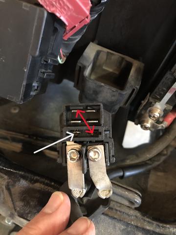

I will certainly have to check over both the Stabilant 22 and the CorrosionX gentlemen. With my gas tank removed I can do some continuity and voltage tests for the ignition. What I have found is: All three wires from the starter relay, clutch switch, start switch and finally the red ignition wire test perfectly for continuity. However, the red wire to the ignition switch at the multi plug underneath the tank shows no voltage coming from the relay. With 12V showing at the relay and a good 30A fuse, it is not showing any voltage at the appropriate pin, delivering to the ignition plug. I am assuming, with a good starter relay, 30A fuse and 12V delivered to it, there would "always" be voltage showing at the red wire. If all other conditions are good, and no power showing at this pin of the relay, the relay is bad. I do believe the starter relay I am working with now is a new one I purchased last year from Amazon and didn't try it out much then. Any confirmation from the group is always appreciated as I prepare to purchase another relay from the Honda dealership.
WintrSol
OK, the battery terminal on the starter relay goes to both the relay contact and to the 30A main fuse. The other side of that fuse goes to the red wire contact. If 12V is that contact blade, but not at the other end of the cable to the switch, perhaps the contact in the mate has collapsed internally. Use a bright light, and maybe a magnifier, to examine all four; they should all look alike. If there is no power at that blade contact, which mates to the red wire, then it is broken internally, or the contact for the fuse is bad; possible the fuse has a crack, and tests good but fails under load. Start with a new fuse.
Piper Archer #1
Thanks again WintrSol, this is very helpful. I first switched out to a new 30A fuse and found no difference. I did confirm with a continuity test the Rt. side of the fuse is connected to the red wire blade, as you stated. (Red arrows). I then tested for power on the Lt. side of the fuse and fount it is "grounded" (continuity) no power. (White arrow) I think this would confirm the relay is bad. I have noticed on the relay near the main connections a "B" on one side and a "M" on the other side. curious about those letters?
WintrSol
Quote from: Piper Archer #1 on Fri 21, Aug 2026, 16:45:46Thanks again WintrSol, this is very helpful. I first switched out to a new 30A fuse and found no difference. I did confirm with a continuity test the Rt. side of the fuse is connected to the red wire blade, as you stated. (Red arrows). I then tested for power on the Lt. side of the fuse and fount it is "grounded" (continuity) no power. (White arrow) I think this would confirm the relay is bad. I have noticed on the relay near the main connections a "B" on one side and a "M" on the other side. curious about those letters?
If the two contacts marked with the red arrow represent output end of the fuse and the contact for the red wire in the harness, then the one marked with the white arrow should go directly to the battery(+) terminal, so should always read 12V. That means no continuity to ground at all, even with the battery disconnected. The only way to get continuity to ground is if the two large wire connections (battery(+) and starter motor) are reversed. So, with the battery disconnected, measure continuity from the fuse contact marked with the white arrow to each of the large wire connections; the one it measures to should go to the battery(+) cable, and the other to the starter motor (which will show continuity to ground).

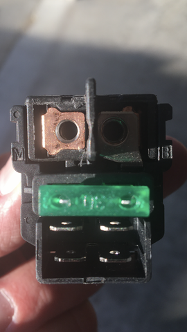

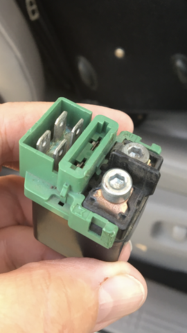

Piper Archer #1
The relay I have been trying and testing is a new one I purchased some time ago, and I had since lost the old relay. However, I did find a photo of the relay previously in my Valkyrie. See new photo posted. The old relay has the "M" and "B" on the opposite sides compared to the new one I have tried to use. With this in mind, I just ordered a new relay which matches perfectly with the old. Interesting, both of the relays are advertised for my bike perfectly. I'm hoping that letter difference will make the difference I need.  ;D  Just shows even an old man can learn new things, especially with great, experienced riders assisting. Thanks again!
WintrSol
If we assume M and B mean Motor and Battery, then that explains the results. I would verify that the fuse connects to the terminal labeled B on both relays, just to be sure. It probably IS compatible with the bike, if you connect according to the labels, not the way the old relay was connected, but, yeah, I wouldn't use the one that seems to be reversed inside, to avoid future confusion. I probably would have missed that detail, too, and I've been doing this kind of thing for over 50 years. :tickedoff:

Finally, I have my update on my electrical repair. Through this process I was able to educate myself on each of the safety switches, which I wasn't even aware of. Thanks for the great input many members assisted with. I was sitting with this problem since the spring of 2024 after winter storage, and my Valkyrie sat in the garage, gathering dust while I try and find time to work on it. Last week the correct starter relay showed up, and I dedicated much time to put everything back together and hope for the best. Anytime I am working on our vehicles, I spent considerable time cleaning where I likely never had the opportunity. This was no different for my Valkyrie. The new relay with the letters B and M on the correct side, made all the difference. My Valkyrie is now all back to her old self, and running very well. I want especially to thank member WintrSol for his great input through my repair.
If I can find anyone interested in having the extra starter relay which is listed as a great fit for a 1998 Valkyrie, with the B and M on the opposites to mine. I will offer this relay to anyone who may be able to use it at "No Cost" "Free".
