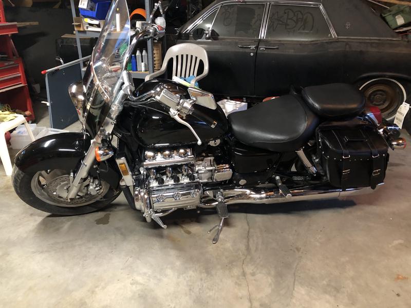

Piper Archer #1
After winter storage I have no electrical power, even with new battery and all fuses checked and everything checks OK and still no power. Can you give me some suggestions to
 solve this problem?

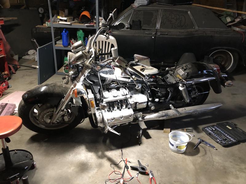

I would like to pass on this question to the group and especially those couple who have assisted me greatly already. As I inspect my wiring and switches and sensors and reconnecting, including the wiring stuffed inside the headlight shell. Is it good to use a dielectric grease lightly when reconnecting electrical connections. I just don't like to leave connections dirty and very dry and difficult to know you have a great connection. I appreciate everyone's thoughts on this topic as I search for my grease in my garage.
Piper Archer #1
Update: As I continue to check through safety switches, confirm OK and reinstall, I finally decided to check through the Side Stand Switch. Photo of the side stand is showing three wires cut off, and no switch in sight. With this check I don't believe this is the cause of my electrical problem. Of the three wires cut, the two green were wired together and the one yellow/blk stripe wire is bare. Apparently, this was altered prior to my purchase about 10 years ago. We have used the motorcycle every summer without any problems. Obviously, someone earlier connected the wires together, which is bypassing the safety switch.
