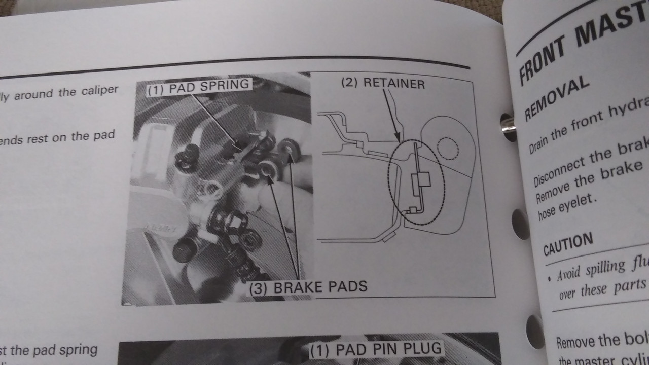

 Below is from the OEM Service Manual.  The "spring" is to be installed first, before the pads. then you push the pads against it while installing the pin.
Hope this helps.

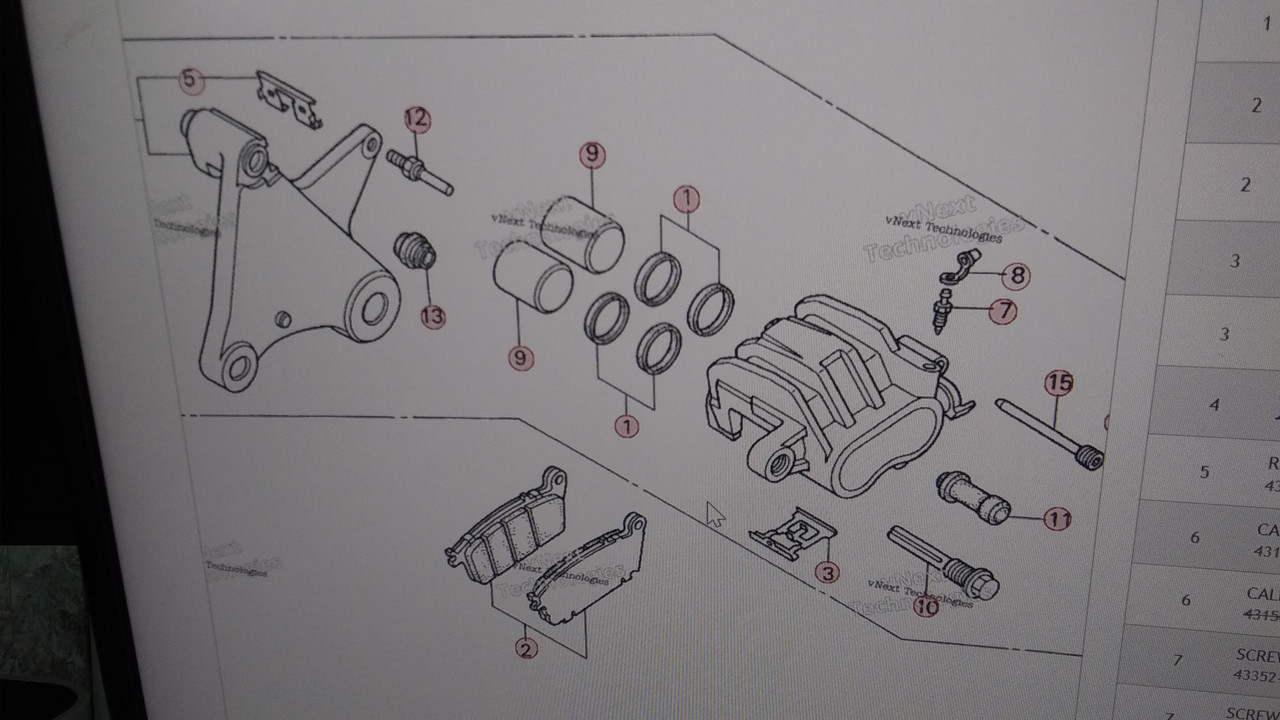

Here's a picture from a OEM parts supplier.
