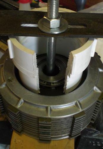

After many months I finally got around to replacing the clutch on my ’98 Tourer.  As some others have experienced, the rivets in the damper plate failed.  This is not uncommon on some high mileage Valks.
The job took several hours, but was not difficult at all.  Getting the center plastic cover off was more of a PITA than any of the other work.  Clearance isn’t as good as in a bike with a more typical transversely mounted engine, but once you have it on a lift with a few pieces removed (I didn’t even remove the tank) there is plenty of clearance to remove the rear cover and clutch center pack without any special tools (not even a wobble joint for your ratchet).
Here are of a couple of things I learned:
I’d read that the disk alignment must nearly perfect or the compressed clutch center pack will not fit back into the basket.  I used a couple of large washers and a spring in 2 places to hold the pack together with some light pressure.  This allowed me to align the disks in the basket, and keep them aligned when I compressed the diaphragm spring and replaced the circlip.
Speaking of compressing the spring, I made a simple tool out of a 2x4, long bolt, a plastic pipe fitting, and an old lawnmower blade.  I knew that blade would come in handy one day!  This allowed me to use straight tips on the circlip pliers which seem to work better than 90 or 45 degree tips.
While I used an impact wrench to remove the big clutch nut, I wanted to torque the new one to the Honda spec.  Here’s a simple clutch holder tool I made from another 2x4.

How high of mileage are you talking about?  When the rivets failed, what happened?  Did you have any advance warning?  Did you create these "tools" off the top of your head, or did you have a link to guide you?
My mileage is a bit less than 149,000.
I'd read about the failure symptom in another post.  It is very easy to ID.  The clutch lever only pulls in about half way.  This probably occurs because the rivet is working it's way out of the pack, and is temporarily stuck between the damper plate and a friction plate.  Centrifugal force quickly spits the rivet out, where it drops to the bottom of the clutch housing.  Everything seems normal after that, until the next chunk of rivet causes a repeat.  Of course, you now have fewer rivets in the damper plate, so the remaining ones have more stress.
The tools were simple to make.  The holder was inspired by the Honda tool in the manual.  Some have just tightened the nut with an impact wrench, and some shops do as well.
The compressor is similar to one in a previous post on the board, though they used metal pipe where I used the plastic pipe joint because it is way easier to cut.
The idea to hold the pack together with washers and springs was my own idea.  I'd read that others had to make multiple attempts at aligning the disks with a straight edge, so I wanted to avoid that frustration.
