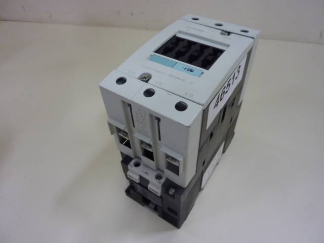

get a contactor and make sure it has a 120v coil on it (I've got a couple if you need, email me and I can mail it to you)
wire the coil to a regular wall timer, wire the 220v heater through the contactor.  easy-peezie
http://www.ebay.com/itm/like/301027037219?lpid=82

Alph's contactor idea would work fine as long as the contacts are rated for the heater's current or higher. Also, that white wire you used to connect to the heater red wire....it goes to the other side of your double pole breaker- beneath the black, correct? Just checkin...If it's part of a two wire romex with ground, it should have a piece of black tape around it or paint mark on it to signify it's not a ground in this instance.
