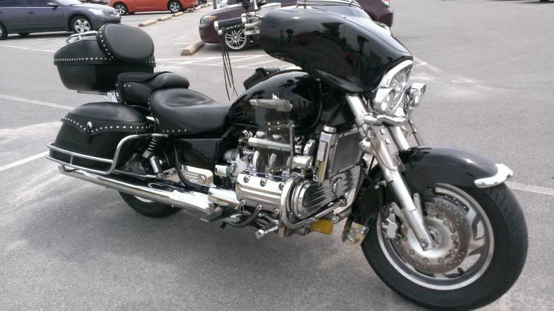

« Reply #18 on: March 27, 2014, 02:44:18 AM »
Wally World is where this China one was purchased. Did a search last night and Advance Auto
has them in stock at $6.09 each (yellow).  We have that store Smiley only 3 miles from my address.
Yellow on a Black & Chrome Tourer Sad  the color will be changed or covered.

« Reply #20 on: March 27, 2014, 09:20:48 AM »
What's wrong with a yellow oil filter?
You could always paint it black...or use an oil filter cover.  Just know that if you're using the longer of the Pure One filters that most chrome oil filter covers won't fit over the longer filter.
