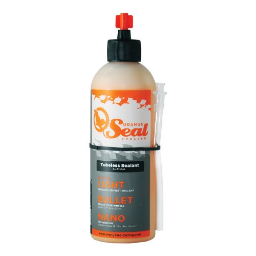

My mt. bike has tubeless tires. They only work because of some ride-on like goo that
people put in them. It must not be quite like ride on, because it seals at the
bead as well as on the tread. There's a Utube video of some guy in Europe
putting it in his tire with a needle and syringe, it seals the needle hole too.
I put mine in with this syringe that has a tube with a valve stem connector on
it, I plan to install my ride on in my new Avon with this thing and see
how it works...
Ride on seems to balance well, and I hope it keeps me
from ruining a ride (the mild bunch won't leave you behind if
you break down, so one flat impacts everyone...)
