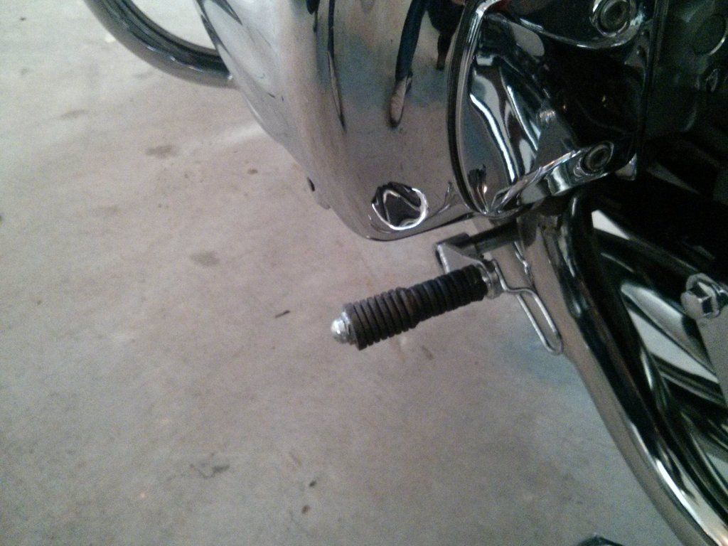

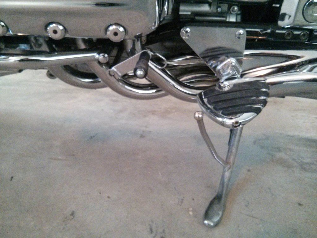

I modified my OEM shifter:
I drilled out the pedal and threaded the hole for 3/8" coarse thread and inserted a length of a stainless steel bolt with the head cut off (with epoxy as thread lock)  to add about 1 1/2" of length to the pedal.
I then slid rubber grommets on to fill the added space and then the shifter rubber. Last was an acorn nut with half the hex nut ground off to avoid metal to leather contact with my riding boot (also installed with epoxy).
I also cut the top wire off the shifter arm so that I could raise the pedal enough to clear my boot for upshifts... which has a thick vibram sole and tall toepiece.
The pedal is far enough past the valve cover to make downshifting easy...also the shifter is raised enough to avoid pavement contact for you footpeg draggers out there!!

Similar to my shifter mod only easier and better looking...you still need to drill out the pedal and thread it and...cut the upper wire on the shifter to raise the pedal enough for boot room under the pedal.
