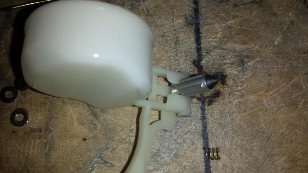

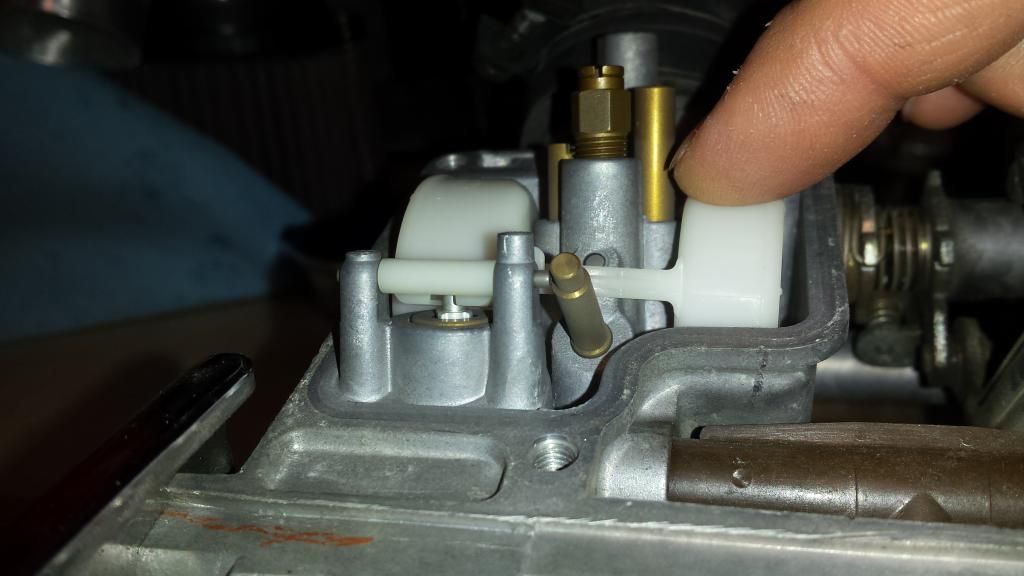

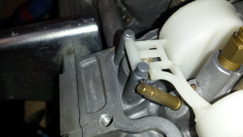

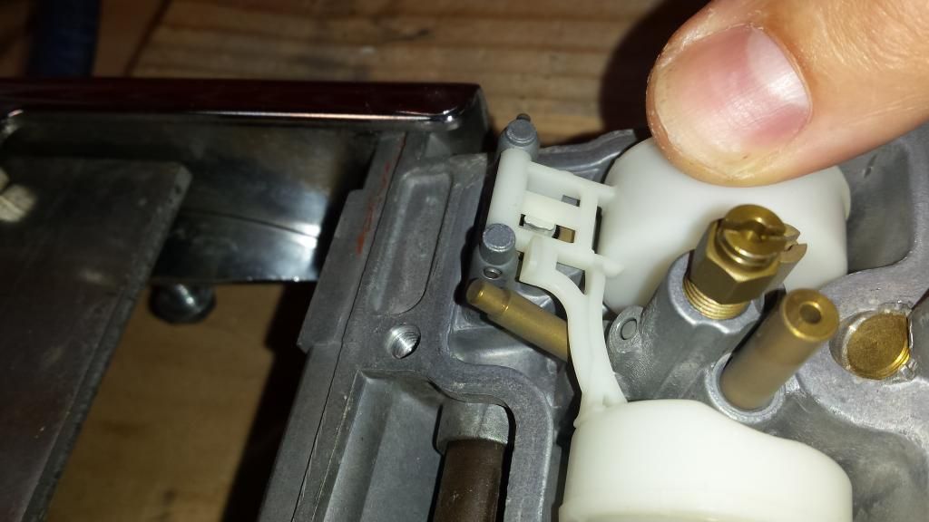

I am currently loading up a video on youtube discussing what I believe is causing the hydrolock condition and how we need to fix it.  I was hesitant to even post this thread because I do not want to start a disagreement over whether its the float needles or the petcock, because its neither in my opinion.  please watch my video in full first and then post your responses.  I thought a video would be the best way to show what I have found.
The float height is the problem, which the floats are non adjustable but I think I have found a solution.  I would love to hear all constructive criticism so we can work together as a community to find a confirmed fix!
This came about on my recent "turbo valkyrie" build, and I thought this would be a perfect time for me to help the valkyrie community solve a dreaded problem.  Funny thing is, I didnt know you guys were having issues with flooding the motors intermittently or I would have looked into this sooner...
with the turbo build we have to run an electric fuel pump to increase pressure as boost increases so it is important that the needles and floats operate properly, I have never had an issue like this after turbo'n any other motorcycle, it just boils down to the fact that the electric fuel pump to accents the already known issue with the valkyrie carbs...
still waiting on video to upload on youtube.  as soon as it uploads I will post a link to it...
And I do apologize in advance because towards the end of the video the camera was not focusing very well to show some of the details I was want to show....

Great work there.  The video focus could use some help on the parts where you show the spring on the float needle.  Maybe you could add some still pictures in the forum to help guide others better.

I think your theory has merit.  I wonder though why Honda would have made the floats not adjustable.  You would think since they offer a specified height that there would be some way of achieving/maintaining that height.
I have never taken a Valkyrie carb apart, but I have had several other cabs opened up and the tab that closes the needle valve is usually a metal tab that can be bent.  The Valkyrie looks all plastic.
Im wondering if a heat gun and careful work could produce a "permanent adjustment" to the plastic where it contacts the float.
I also wonder if somehow we could get an answer from Honda as to how they set the float height at the factory.

If the float height is adjusted to avoid the floats hitting the carb body then the fuel level in the bowl changes which requires jet or needle adjustments to get the fuel mixture corrected. That said, if the float levels are as wrong as they are in your set-of-six carbs then things are already out of whack and all of our bikes could be running better if this is corrected.
In other bikes I'd use the actual fuel level in the carbs as a means of setting the float height. I do this by putting a piece of clear tubing on the bottom of the carb bowl and filling the carb with fuel. Many carbs have an external mark for the correct fuel level. The float height measurement itself is only used as a starting point for this adjustment. Actual fuel level measurement is a pain because it takes a lot longer - and you need some method of fine adjustment, but at least you're focusing on the core issue versus float height.
Nothing that I have said above is meant to detract from your observation that the float must be able to thoroughly stop the flow of fuel into the carburetor and do this without the interference of the floats contacting the carburetor body.

Quite interesting. The height difference of the 2 floats was apparent in the video. I've seen the innards of neglected fuel systems with ethanol and my wonder is are the floats up to the ethanol longer term? Good catch.  cooldude Thanks for sharing this information with us!  coolsmiley RIDE SAFE.

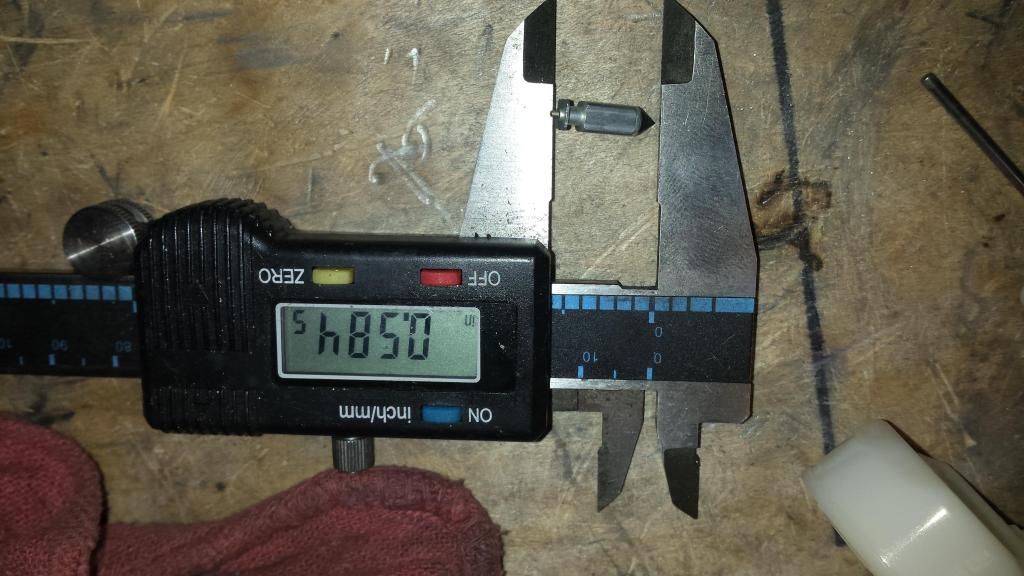

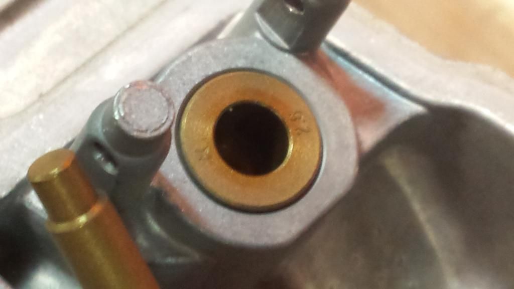

As others has stated, this is interesting. Th floats used in Valkyrie carbs are only used for the Valkyrie.
On the other hand, the float needles themselves are used on many different models of Hondas and probably other makes.
here is my idea, Is there a longer float needle available that would accomplish the same thing without using springs or other items that can fall out and cause havoc?

My take on what he is pointing out is that the floats
can possibly touch the top inside the carburetor
thereby prohibiting the needle from seating and
therefore causing the system to leak gasoline.
Nothing more.

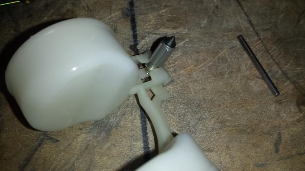

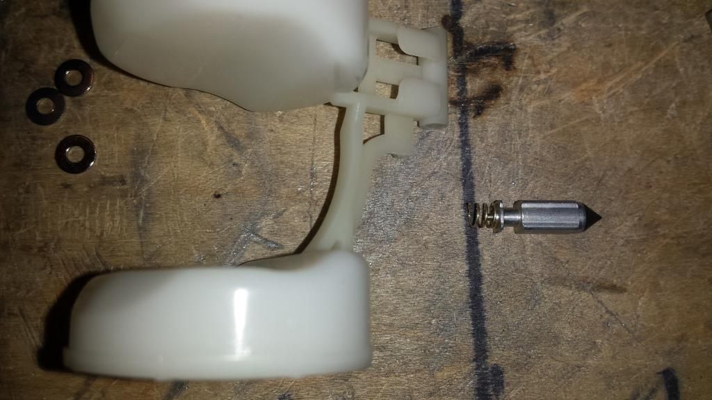

thanks for all the replies guys and good questions!!!
so this is not what I would call a confirmed fix at this time but its for sure one step closer than what we have imo...
I have thought of a longer needle, that would be perfect except the length would have to be exact to have the float level at the correct spot, i like the idea of some time of way to adjust the height
wish i had a brand new float to compare these floats with that would prove or disprove my assumption of the warped floats.

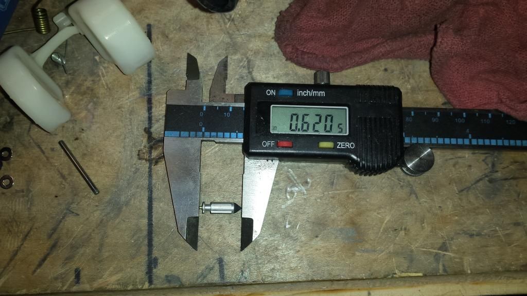

I've been examining a set of carbs and haven't found any of the floats to be contacting the carb housing before fully seating the float needle.
For those that haven't looked closely at the float needle there is an internal spring and a pin extending from the top of the needle. This sprung pin is what makes first contact with the float as the float rises. As the float continues to rise the float then makes contact with the float needle BODY. (This happens before the spring pin is fully compressed.) The float pushes directly onto the seated float needle and this is what stops the float from rising any further.
To verify this, measure that the float drops farther (and stops when it contacts the car body) after the needle is removed. In all six of my carbs the float drops further after the needle is removed.
There must be a measurable difference between these two measurements: The float height with the float compressed (as if a full fuel level) AND the float height with the float needle removed.
If there is no measurable difference then indeed the float is hitting the body which will not allow the float to bear its force on the float needle as designed. If this is the case then I'd certainly replace the float and needle and remeasure to make sure there is clearance. I measured as little as 0.005" difference but, again, all of my carbs had some clearance.

actually the none adjustable float is very common on most bikes in the late 90's and up, but yes it does suck they are not adjustable.  and yes the valkyrie floats are all plastic.
well the heat gun process might be a good idea to try for me, i have a small butane solder torch that would be perfect for that...let me think that over
my theory is that as the float is constantly pushed up by the fuel and against the needle that over time the plastic floats (that would have been designed in the mid 90's) are chemically weakened by the ethanol enriched fuel and warped up by the pressure of floating in the fuel.
i might order a new float just to prove this wrong or right...although what good would it do putting new floats in that are just going to do the same thing?
some company needs to make nitrophyl floats for bass arms that are adjustable for the valkyrie

« Reply #25 on: December 05, 2014, 06:15:03 PM »
Hey BonS,
Have you heard of my brother in overland park, ks? His name is Kyle Moody and he lives on metcalf close to 71st...he is also known around the kc area as "Moody's Garage"....he does the most amazing custom leather tooling and metal forging that I have ever seen.  You should stop by his studio at his house sometime and check it out, just look for the old cars in the driveway on metcalf and tell I sent ya...
anyways back to the matter at hand, BonS here is the pics of my floats contacting the body and it is barely touching the needle's pin, and for sure the body of the needle never touches the float

« Reply #26 on: December 05, 2014, 06:19:08 PM »
BonS,
can you look at the number stamped in the seat housing.  Mine has a 2.6 stamped on it.  I wonder if Kiehin used different depth float seat housing to adjust the float heights.  maybe there was different housing depth options that could have been pressed in during manufacturing of the carbs?

« Reply #27 on: December 05, 2014, 06:22:14 PM »
total pin height
with the pin compressed

how your needle sets in the floats (oem)
small coil spring on top the needle (pretty much replaces the spring loaded needle pin)
coil spring and needle installed into the float
coil spring setup and float installed in the carb

BonS
Posts: 2198
Blue Springs, MO
« Reply #29 on: December 05, 2014, 06:55:12 PM »
Your picture here does not show the part of the float that bears on the spring pin and pushes the float needle closed.
Rather it is the center bar (circled red) shown here that is the fulcrum.
All of my seat housings are marked 2.6 and I measured a needle to be 0.6235" relaxed and 0.5690" compressed. The compressed measurement is iffy due to the soft tip.

« Reply #31 on: December 05, 2014, 07:37:54 PM »
i took a picture just like you did but in that pic you really cant tell anything.
what is your measured float height on your carbs?
i agree the compressed measurement was a pita...
here is my pic but you can't tell by this pic or any angle for that matter the squared off part of body is not touching the middle bridge

« Reply #34 on: December 05, 2014, 08:04:18 PM »
BonS,
can you please take a measurement of how high the seat housing protrudes out of the carb body, may just be shadowing but it almost looks like yours sticks out further than mine (no pun intended).  mine is almost flush

BonS
Posts: 2198
Blue Springs, MO
« Reply #35 on: December 05, 2014, 08:31:22 PM »
These pics might help. The first picture shows the seat housing. I measured several and they're all about 0.011" proud.
The spring loaded pin is at the center of the float needle. The red circle shows the contact patch where the float fulcrum meets the needle after initially contacting the spring pin.
The float fulcrum is pressing on the top land of the float needle.

moodyvalk
Posts: 150
SE Kansas, NE Oklahoma
« Reply #36 on: December 05, 2014, 08:39:10 PM »
The spring loaded pin at the center of the float needle. The red circle shows the contact patch where the float fulcrum meets the needle after initially contacting the spring pin.
ok awesome, I will check my protrusion tomorrow if I get time.
and yes sir, I complete understand and understood.  I would almost bet I could run a piece a notebook paper inbetween my needle contact patch and my fulcrum (man that almost sounds dirty, lol)

BonS
Posts: 2198
Blue Springs, MO
« Reply #37 on: December 05, 2014, 08:50:07 PM »
Your image here seems to show your seat housing is a bit proud of the body.
If the needle body is flush or recessed I can definitely see this as a problem. Earlier I mentioned that there was as little as 0.005" difference between the floats bottoming on the carb body and bottoming out on the float needle. Tolerances are certainly tight here.
