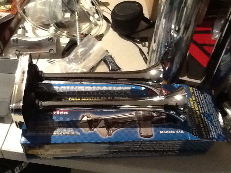

Any suggestions on mounting locations?

I believe most mount them on the top of the crash bars over by where the OEM horns are.  I've got them on all my bikes and that's where mine are.
You'll need mounting brackets, which I believe, I found at a custom shop and on the web.
My compressors are mounted under the right side cover, zip tied to the frame w/o any issues for years.  I run the hoses under the tank.
They get attention from lookers and drivers.

I think my air wings may be in the way.

This is the quickist pic I could find.
The air horns mounted on the crash bar are just ahead of the air wings and don't interfere.

Mounted mine on left side, made a bracket and bolted it to trans cover near oem horn spot.

Had a similar pair mounted on my IS, but they were underneath the frame, pointed to the right .  When I installed the permanent lift adapter I pulled that horn and installed a Stebel on the lift adapter bracket and still have the stock horn... Works well.
That horn is quite loud.....you will love it no doubt.
