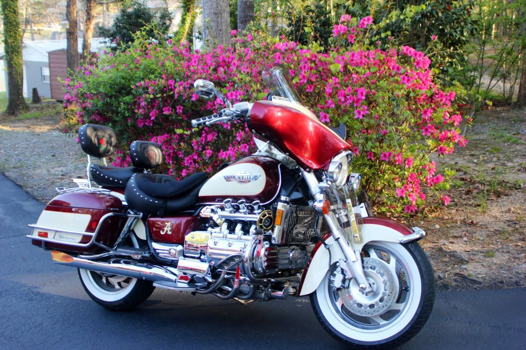

Posts: 88
Lake Martin, Al.
Re: Whitewall tires
December 29, 2014, 06:27:47 AM »
I like mine
Woton
Posts: 410
Central North Carolina
Re: Whitewall tires
Reply #6 on:
December 29, 2014, 08:54:38 AM »
Yes... That's really sharp!
Seems our tastes are similar.
