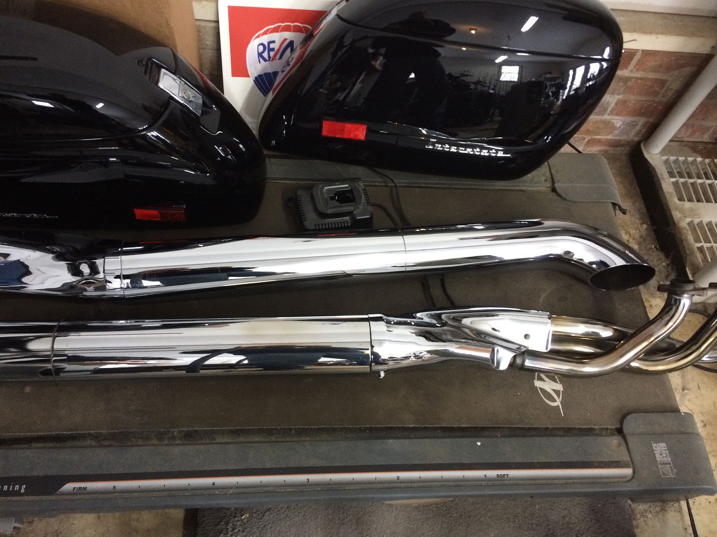

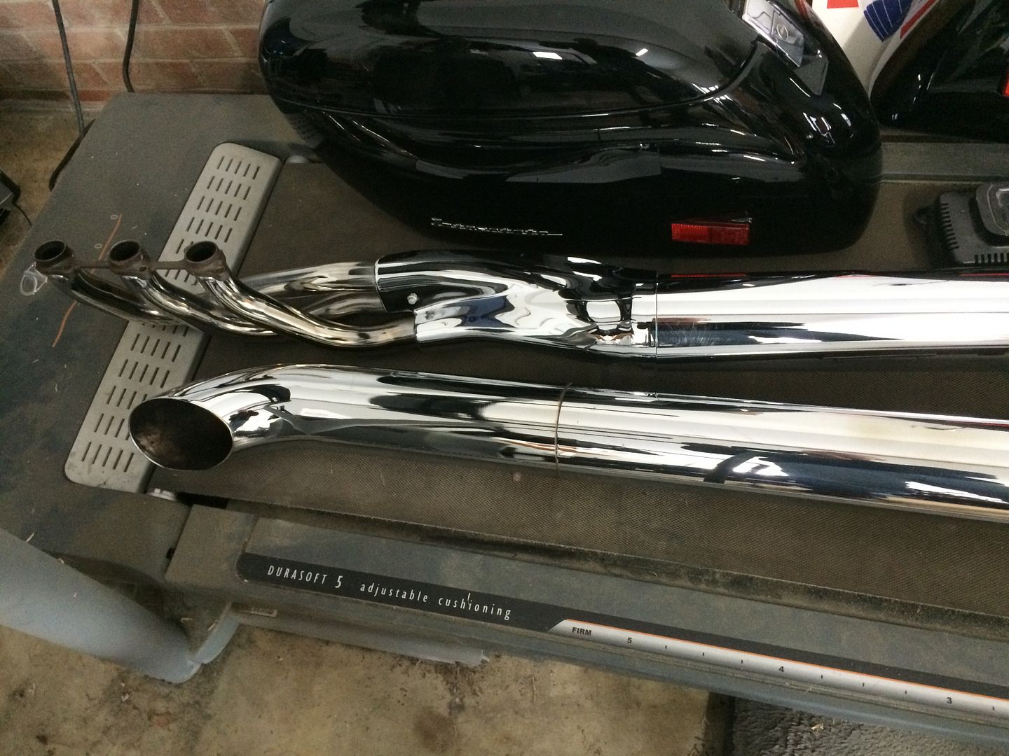

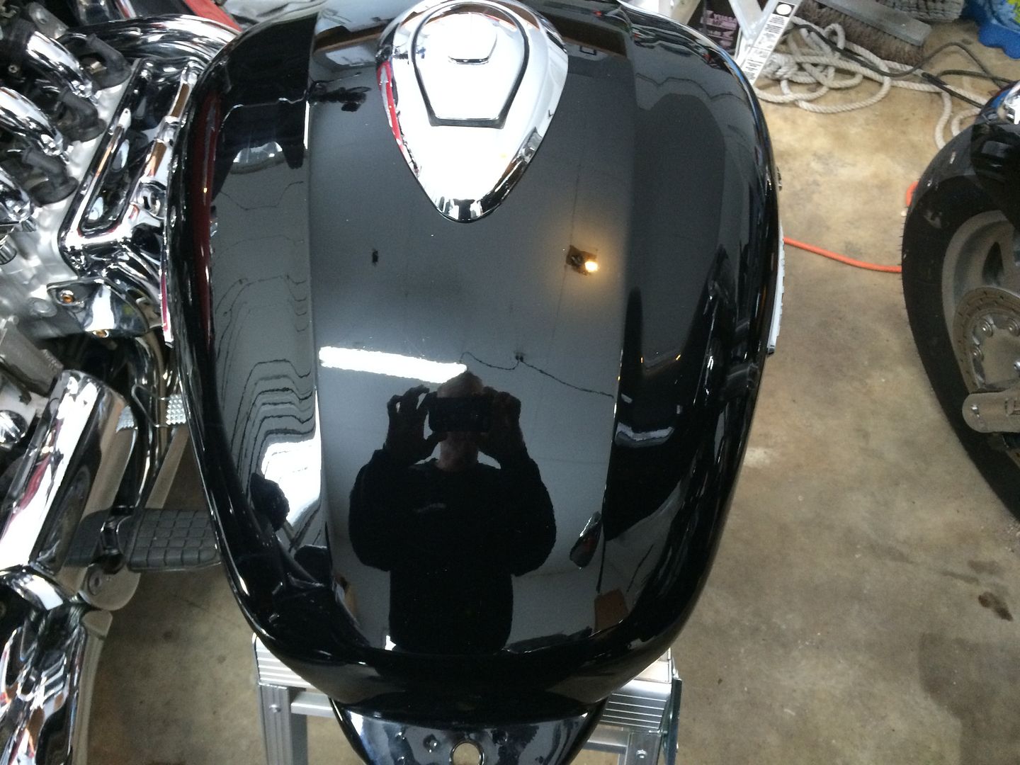

Well, parts are a week away so there was not much for me to do...... except pull out the buffer and start working my way through this thing that has been shut up in a barn since 2008.  I was skeptical at first, but with enough cuts of Mirror glaze she is coming through in pretty good shape.  Next, I guess I will consider pulling the wheels and starting on them.
dpcarson
Posts: 405
Lillington, NC
« Reply #1 on: February 17, 2015, 09:20:12 AM »
Oh, forgot the chrome buffing

Based on my experience, the wheels are the least fun project there is.
Use OOOO steel wool and corrosive wheel cleaner or S100 and then hot soapy water to scrub the snot out of them before any buffing/compound/polishing.
Waxing when done (with non clearcoat wheels) makes your work last a lot longer (before you have to do it again).
Remember to lightly silicone (RTV) those bolts and washers when putting your trunk rack back on (waterproofing).

Which Mirror Glaze are you using. Seems like there are many different compounds.

Hand held buffer?

Indybobm: Most if it was cleaned good and then done with fine cut cleaner, and then swirl remover and finished with yellow wax.  The tank and the saddle bags were beat up a little so I touched up the scratched areas with some 2000 grit wet paper and then  went over it with the medium cut, then fine cut cleaner, then swirl remover, and then for the tank I also hit it with machine glaze, and then yellow wax on both.
Thanks for the compliments guys.  It was enough that I could not do it very well with the DA porter cable and had to grab the flex to get a little more bite with the compounds.

Best use of a treadmill I've seen Grin
Hand held buffer?
LOL  That is funny.  And only use I have for it also.  Wife has wanted many pieces of "modern art" over the years.  Yes, handheld buffer.  I use the flex rotary for most of it.  I also have a porter cable DA but it was not biting enough to do what I wanted it to do.  The chrome was done with a palm sander with a 5" buffing pad on it and some mothers.

Looks great!!!!! Was it hard to remove the tank? I have to do that so I can replace the air filter.

No, not at all.  Drain the fuel, remove petcock, two screws and it's off.

« Reply #15 on: February 17, 2015, 01:42:21 PM »
My tank is FULL!!!!!!!!!!!!!
NO need to drain the tank.
Shut the petcock off, undo the lines, take the 3 screws out and lift it up.
I usually stand my tank in the corner on it's nose.   It is easier if you have like a 1/3 to a 1/4 tank.    Gas weights around 8#'s a gallon, so that tank and full of gas, it can get heavy.
