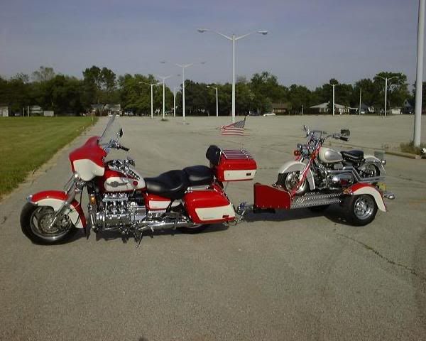

There's some pictures on this site somewhere that show a red & white Valk pulling a custom trailer with a full size cruiser on it.
Pulling a light weight dirt bike wouldn't be a problem I'd think.

Is this a home made trailer? I like this setup allot. Its likely more heavy duty then i would need but would make a good platform to start building.
Hard to say if it is home made or not, but the wheel/fender combo looks very much like the ones I have on my American Legend trailer.  Suppose it is possible they made a bike hauler as well.
