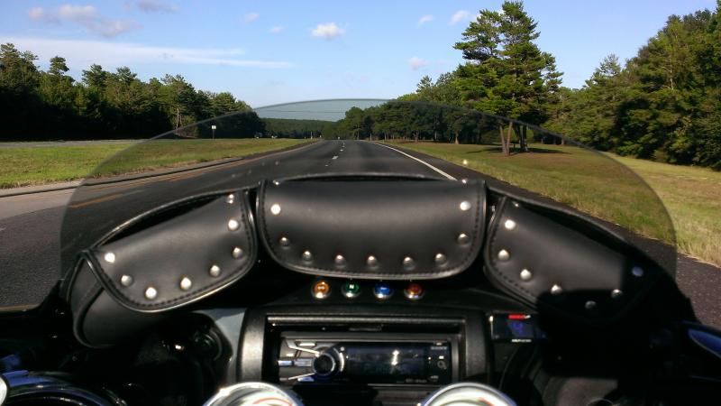

No, I don't have any experience with a Clearview on my Woody's.  I have several Fast Aire shields.
http://www.fastaire.com/products/aero-windshields.php
I have a 4" in black for when I want all the air, a 7" for most of the year and warmer weather months, and a 10" for the cold weather months.
A 10" shield is the closest to the stock OEM Honda windshield on Tourers.
The 7" and 10" are light smoke tint.
My 7" shield.....

Are you looking through your 10" or over it? How about the 7"?
When I had the Honda Tourer windshield on the bike I looked just over it.
With my 10" Fast Aire shield, I look just over it.
The 7" shield, I look over it.....the wind just barely does hit the top of my helmet.....sometimes.
