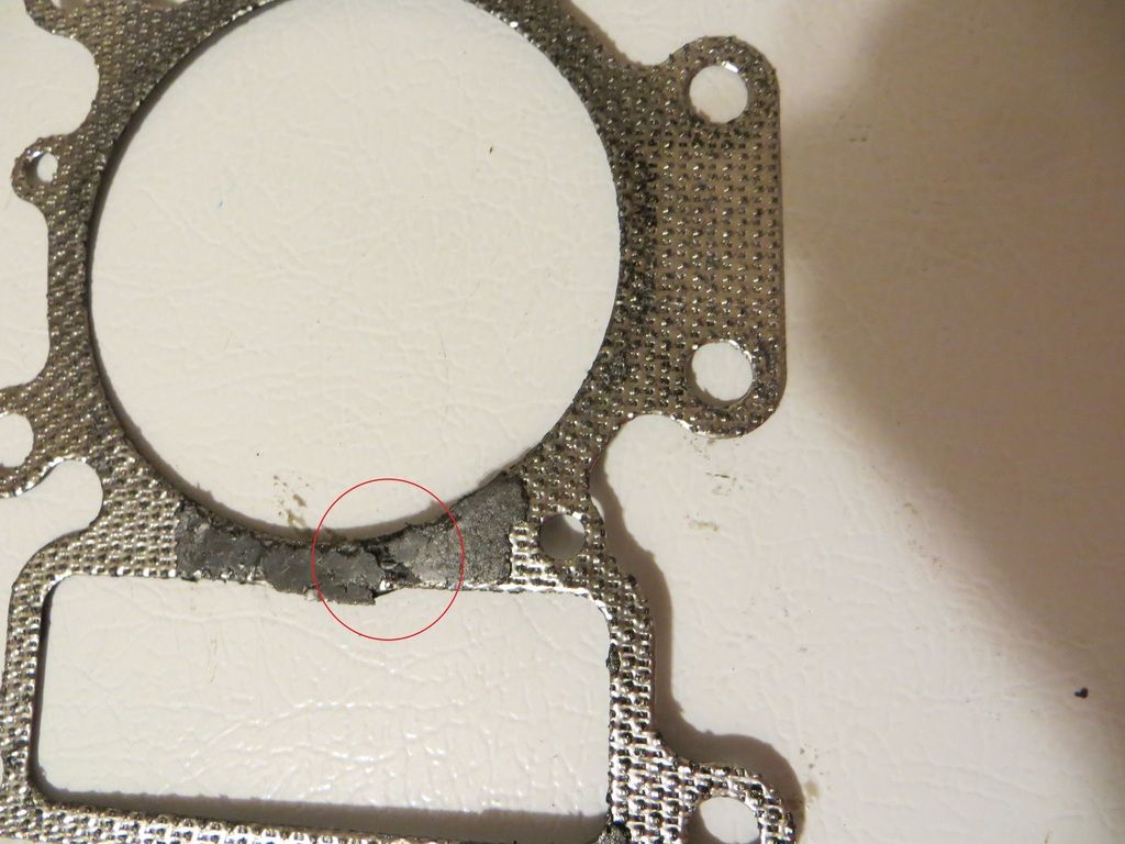

I'd say you have a blown head gasket. the way those head gaskets are set up. it blows between the cyl, and the oil galley for the rods.
after removing all the covers to get the head off shouldn't take ya but about an hour to fix from start to finish.
and yes it will smoke so bad that there wouldn't be a mosquito within 10 miles of that mower. and it happens all at once.

Got the head gasket changed tonight.  Took more like 4 hours than 1.
I'm 99% sure that was the problem.  You can see the gap in the gasket and I could also see the blow-by trial on the engine block.

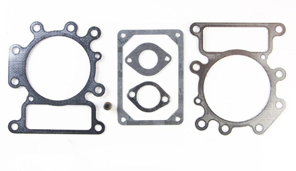

Just one stupid question.  The gasket set came with two (2) head gaskets.  I assume I was only supposed to one--the one one that matched the one I took off?

i believe you assume right because if one is different then you couldnt use it anyway..

I have now used the mower several times and all problems are cured.  No more smoking; no more oil consumption.
No doubt it was a blown head gasket.
