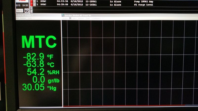

We made the news.  We did something the other day that we've NEVER done before.
http://www.nwfdailynews.com/local/google-s-search-for-test-facility-led-to-climatic-lab-video-1.494217
We advertise that we can do -65...but we've never just tried to go as cold as possible before.  Google wanted us to do just that....go as cold as we could get it.
We have Google as a customer and they're testing their Google Loon project.
http://www.google.com/loon/
I had our equipment screaming and running as hard as it would go.  We officially recorded......
We think we actually went about 10 degrees colder than that, but our instrumentation stopped recording at -82.9* and wouldn't budge after that so we don't have any proof of anything any colder.

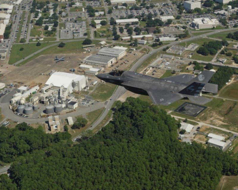

F35....
https://www.youtube.com/watch?v=NcGvW5dAa0A
The F35 flying over our facility the day it arrived for testing.....

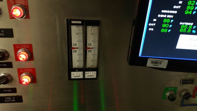

I assume your instrumentation is reading 30" hg because it is converting the temperature reading to a vacuum and not because the entire lab is in a perfect vacuum?
1 atmosphere = 29.92"Hg
« Reply #8 on: June 27, 2015, 02:18:56 PM »
Wrong assumption.  That's reading the barometric pressure from outside.

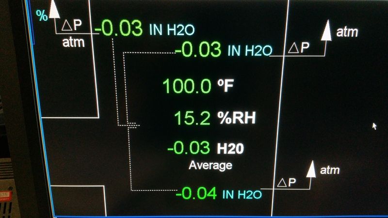

The chamber pressure is measured with an old fashion manometer measuring inches of water column.....
And also with instrumentation....
The chamber does go negative (and positive) from time to time....however, we can correct that.  However, with better than a 160* difference from outside temp to inside temp, the chamber does go negative.  That's a pretty good inversion from outside to inside.
Think of an empty plastic water bottle that you put in an ice chest.....and watch it suck it's sides in.  Same thing happens to our chamber.

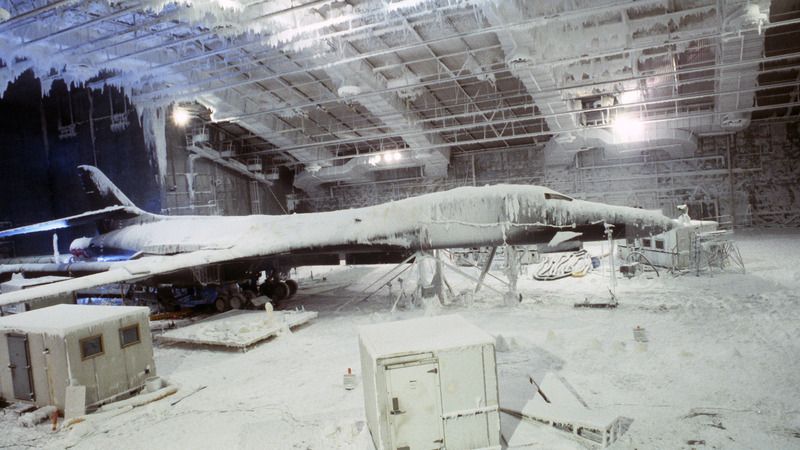

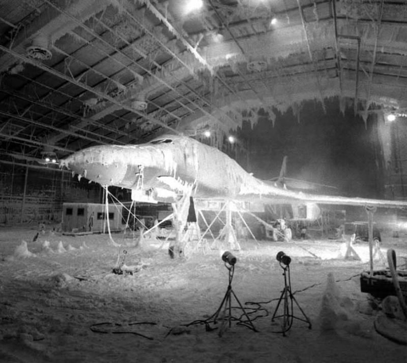

Interesting/neat/weird?  Probably the Navy's LCAC.  That thing was flat out cool....and weird.
http://www.navy.mil/navydata/fact_display.asp?cid=4200&tid=1500&ct=4
Surprising?  During the B1-B test years ago, one night during an engine run test, the flight crew decided that they were hungry and had a pizza delivered.  When it got there, they found out that the delivery person was a cute young girl and they invited her to come into the cockpit to deliver to the pilots.  Pretty sure that was THE most interesting pizza delivery she ever had.
