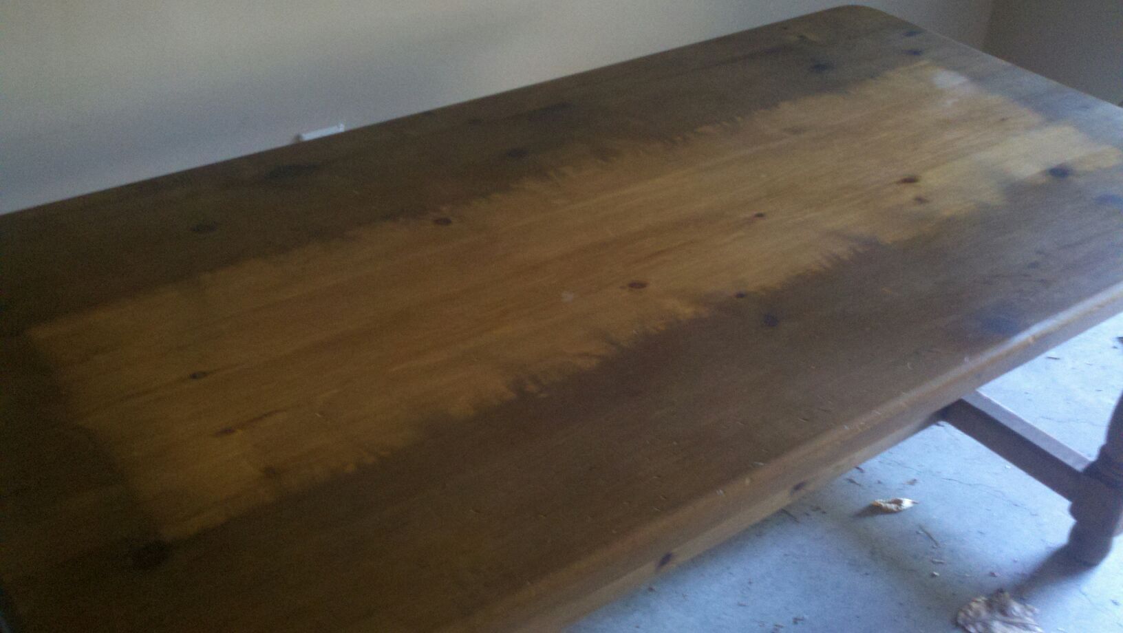

I'm getting back my old pine dining table which has been heavily smoke/soot damaged.
Apart from not letting it get over wet what do I do to remove the staining?
I want to clean it and refinish it myself.
It had a waxed finish which is what I plan on doing.

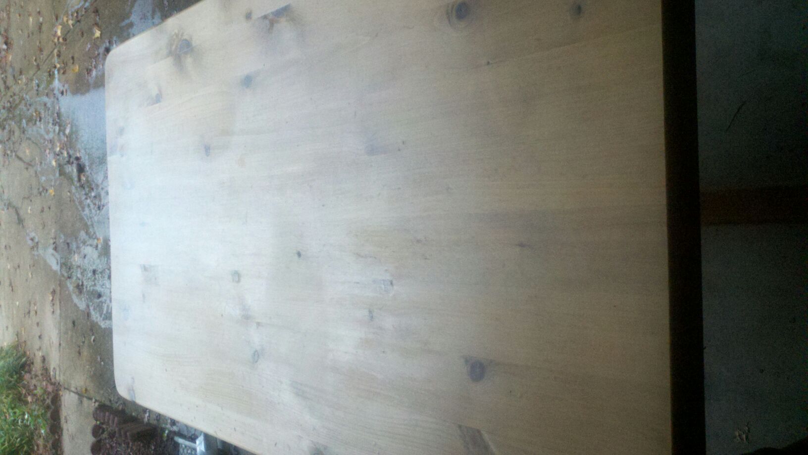

Re: Question for the woodworkers
October 11, 2015, 01:40:41 PM »
Woo Hoo.
Local hardware store suggested TSP which had completely slipped my mind.
It removed the soot/smoke immediately. Also the wax below the soot/smoke.
I think this wax protected the wood 95%.
So the table is clean and now I just need to
