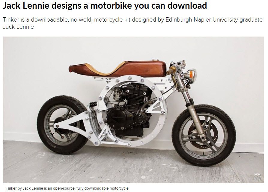

From a rather creative gentleman.
http://www.designindaba.com/articles/creative-work/jack-lennie-designs-motorbike-you-can-download
From a functional standpoint, its novel; Adjustable steering head, swingarm, engine placemenrt; but for a vertical twin, triple or 4, it would be a tall seat. Now for a low profile Valk engine...
Butt ugly though - like something should have been in the latest Mad Max movie...

I don't think it's all that butt ugly. But it sure does look butt hurting though. It's very interesting, but it looks like it would be pretty hard to pull off a shaft drive though. The thought of chain drive just doesn't appeal to me anymore.

I see at least one flaw in the design. The pivot point from the swingarm is WAY below the chain drive. Any movement of the swingarm will tighten / loosen the chain tension. A LOT. Never mind it looks uncomfortable as hell. Sitting on the boys. Might work for a eunich or a girl. Not for me.

I am NOT an engineer but I'm thinkin the C G is up there. And agree wholeheartedly with Mark-Ts observation. MAYBE IF I wuz 40-50 years younger!

I am with MarkT,, I do not see how that would even function.

I hope that was privately funded.
