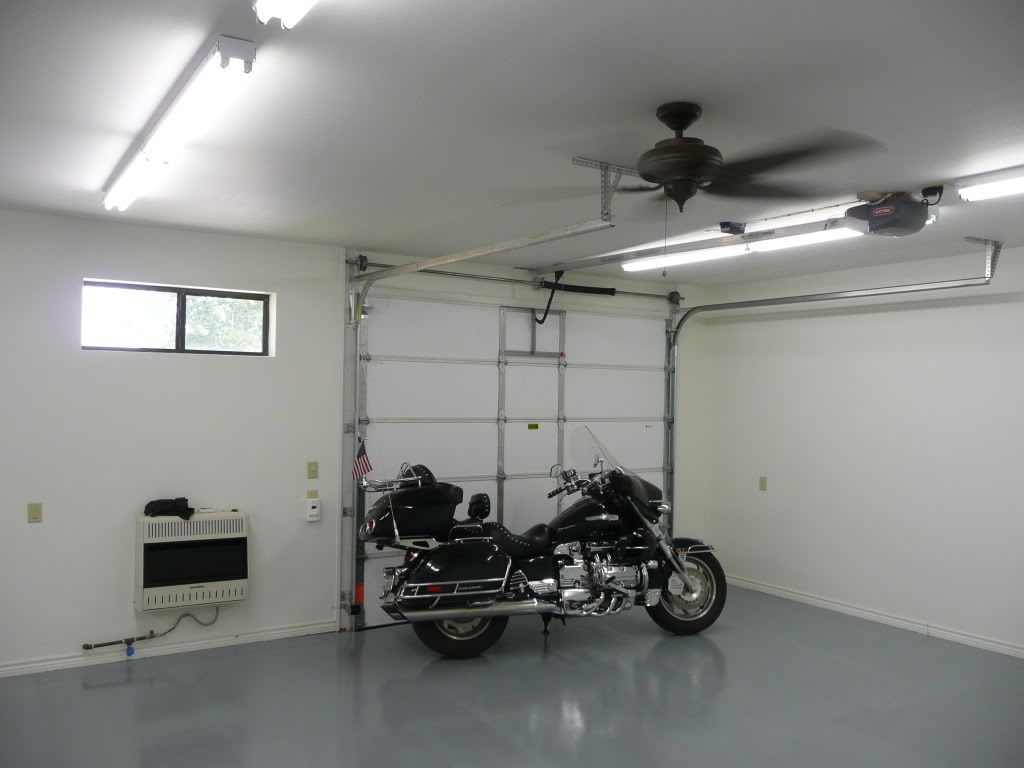

« Reply #11 on: December 31, 2015, 02:43:12 AM »
I have a shop building which has 350 cubic feet more than your garage.  It stays warm and toasty all winter with one NG 30,000 BTU "Mr. Heater" wall mounted heater.  It can be wall mounted or stood up on the floor and has a thermostat on the control which keeps the shop at a constant temperature as soon as you find the proper setting number for the temperature you want. Get the "Radiant Heat" unit instead of the "blue flame" unit.  The blue flame unit will discolor the paint above it if mounted on the wall.  I had two of them installed when I built the building, but only use one since it will more than maintain a 70+ degree temp.  They come in either natural gas or propane units.  Picture is of shop when new, considerably more cluttered 4 years later.
