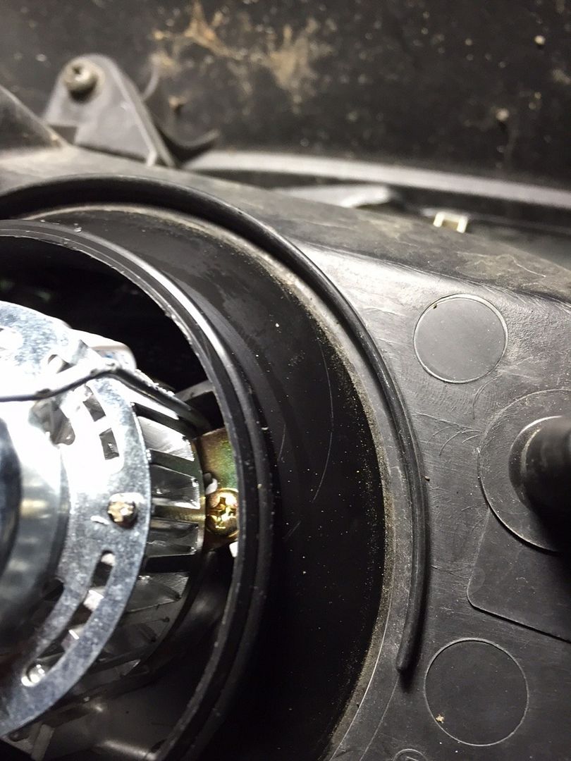

Anybody put them in an Interstate yet and was there any problems with room for the fit?

I seem to remember someone posting about this. They were able to do a little trimming to get them to fit.

« Reply #2 on: February 25, 2016, 01:43:27 PM »
yes they fit.
but your going to have to remove the fairing or at least unbolt it and tilt it forward.
there is not enough room to get your fingers around that fan on the back of the bulb to re-insert the clip.
once i tilted my fairing forward i was able to use a pair of needle nose pliers to reclip it.

« Reply #3 on: February 26, 2016, 09:23:04 AM »
I used a similar Cyron set in my IS and there was no way to get it in with the existing clip without doing some damage so I made a clip to fit out side. They are VERY bright. I may have been able to remove the clip retainage screw and sneak it in but I did not want to drop the screw down into the housing. The reduction in amps is noticed as soon as you start the bike and it gets more volts when cold allowing for more spark. Volts jump to 14 as soon as the motor turns over.
