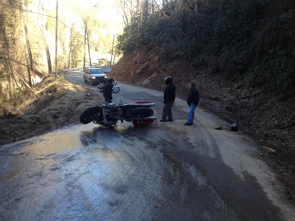

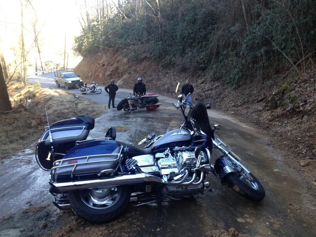

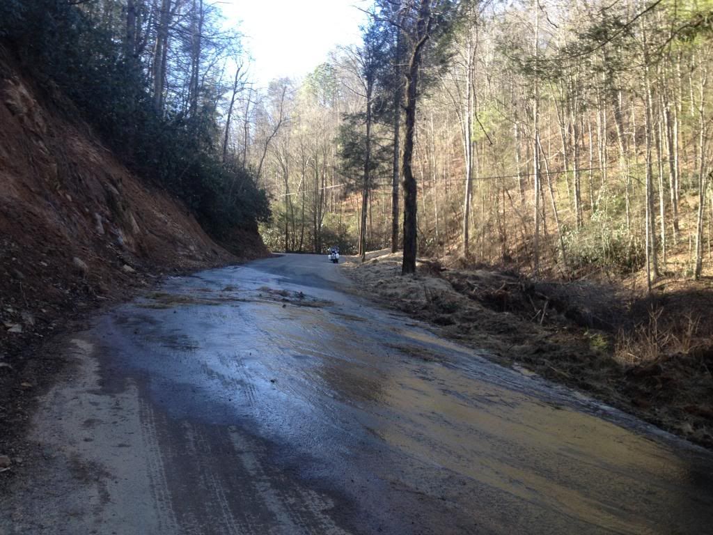

40 to 45 yards of ice... Two bikes down behind me ... I never broke traction and made it....My bike was the only one with a CT.... Car Tire ? Pissie ass luck ?
