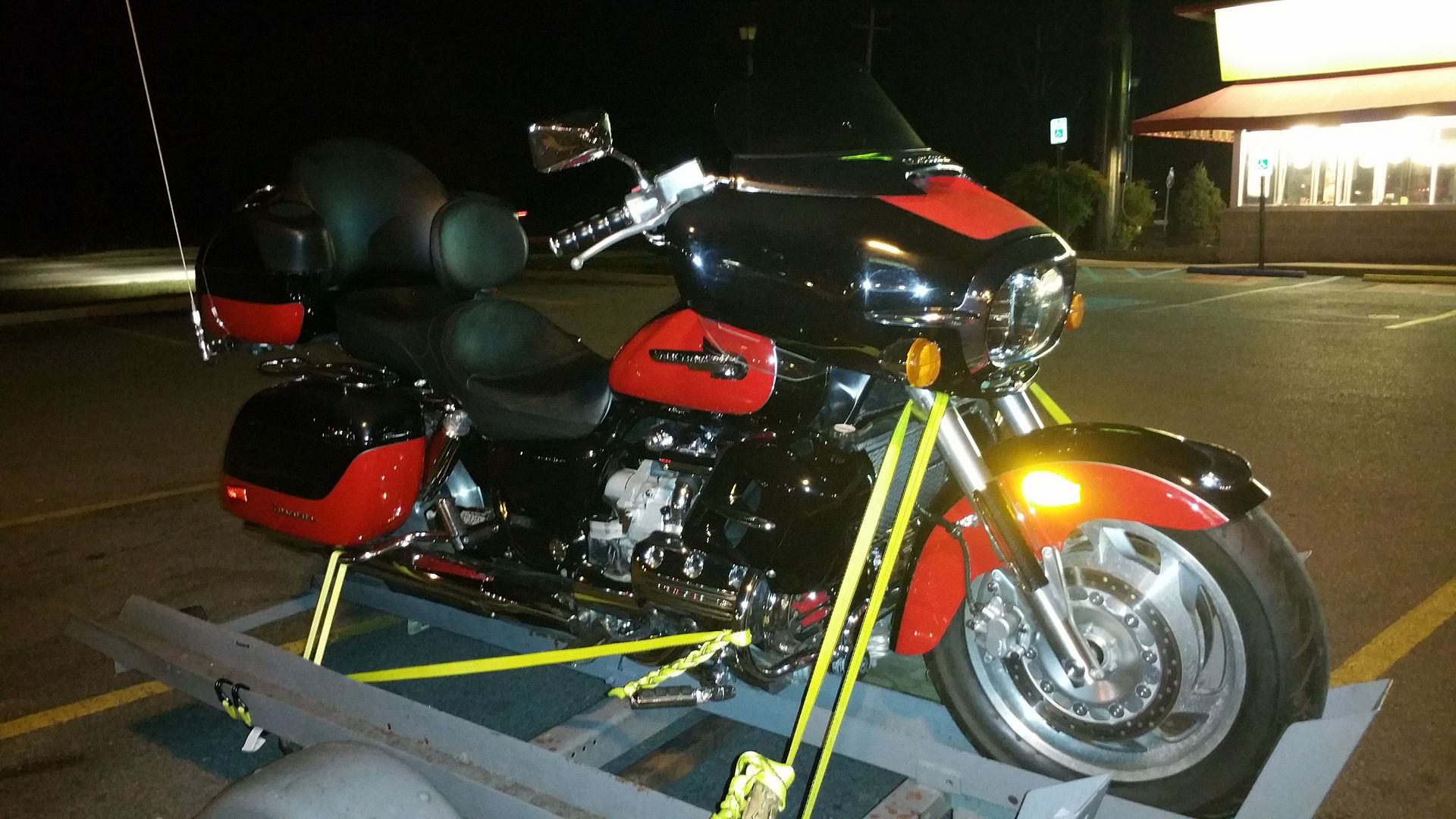

This past weekend, my son and I took the I/S and his Buell to the Tail Of The Dragon, on the trailer. He didn't think he could ride the "new to him" Buell the 650 miles to get there, in one day.
On the way down, I broke two ratchet straps and broke one more on the way home on the I/S. Now granted, these are the cheap ones that I bought at Harbor Freight, WalMart, Autozone, etc... but still...
For reference, I had six straps on the I/S. On each side, I had a strap around the fork/lower triple tree, one on the engine guard and one on the rear bag guard.
The bike was bouncing up and down enough, that the straps were rubbing (I guess) and eventually wore through the webbing.
Are there better straps that are designed to handle a little bit of abrasion without tearing in half?
I am ready to throw all of my existing straps away and invest in something better. Watching the I/S in the rearview mirror for 10-11 hours becomes exhausting, while dealing with July 4th holiday traffic at the same time.
Allan

The first one to break was at the front fork/tree. The second and third were at the rear bag guard.
I think the issue was partly due to not using the soft tie (or loop straps).
I had the ratchet strap itself, up and around the fork/tree and then back down to the anchor.
Although there are a number of suggestions, I think the general consensus is to pay a little more for some better straps.
Thanks for all of the input.
