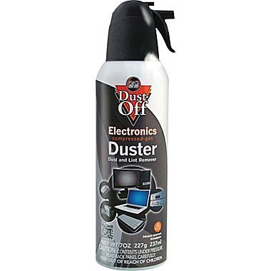

« Reply #16 on: July 31, 2016, 04:17:44 PM »
https://www.youtube.com/watch?v=l-EvHaQGXGA
Since my power may be out when I need it, my compressor would not be available.
Two lengths of surgical tubing, & one of these....
Works like a charm cooldude

« Reply #19 on: July 31, 2016, 04:46:08 PM »
Thanks Whisky, I've been trying to think of how to have a compressor without power.   cooldude
I do have a portable deep cycle battery tire inflator, but have not used it in years (and it is really low power).
